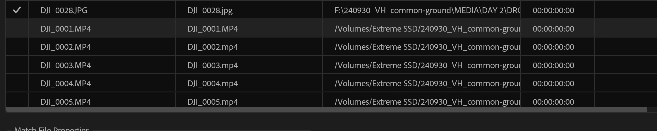

When I open the project, it starts looking for files. It finds a few jpegs and mov files. Then, it says that it can't find these files, which are MP4 (HEVC) 10-bit files.
I go and search for them. It finds the files and I click OK:

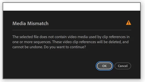

but then I get this message:

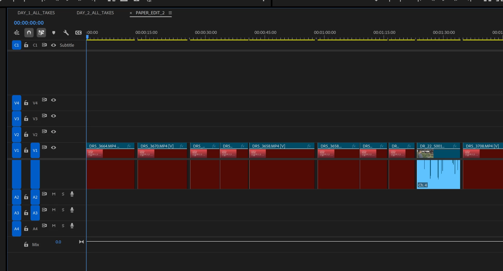

I click cancel and offline all as it doesn't get me past this and it shows the timeline with the files being offline.

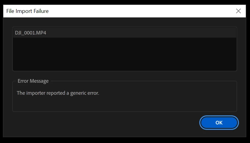

If I try to link media, I get this error:
If I click OK, nothing happens.

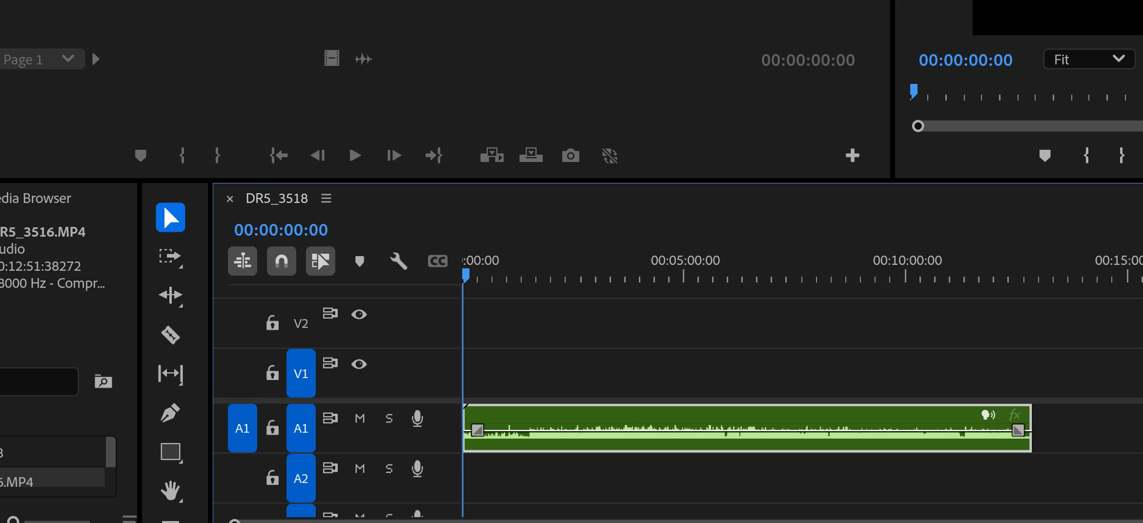

If I open a brand new project and try and add the file in, this is what I get. The video file doesn't show, just the audio. So it's not the sequence/project of the original.
When I convert the same file to h264, it appears fine. The video component you can see.

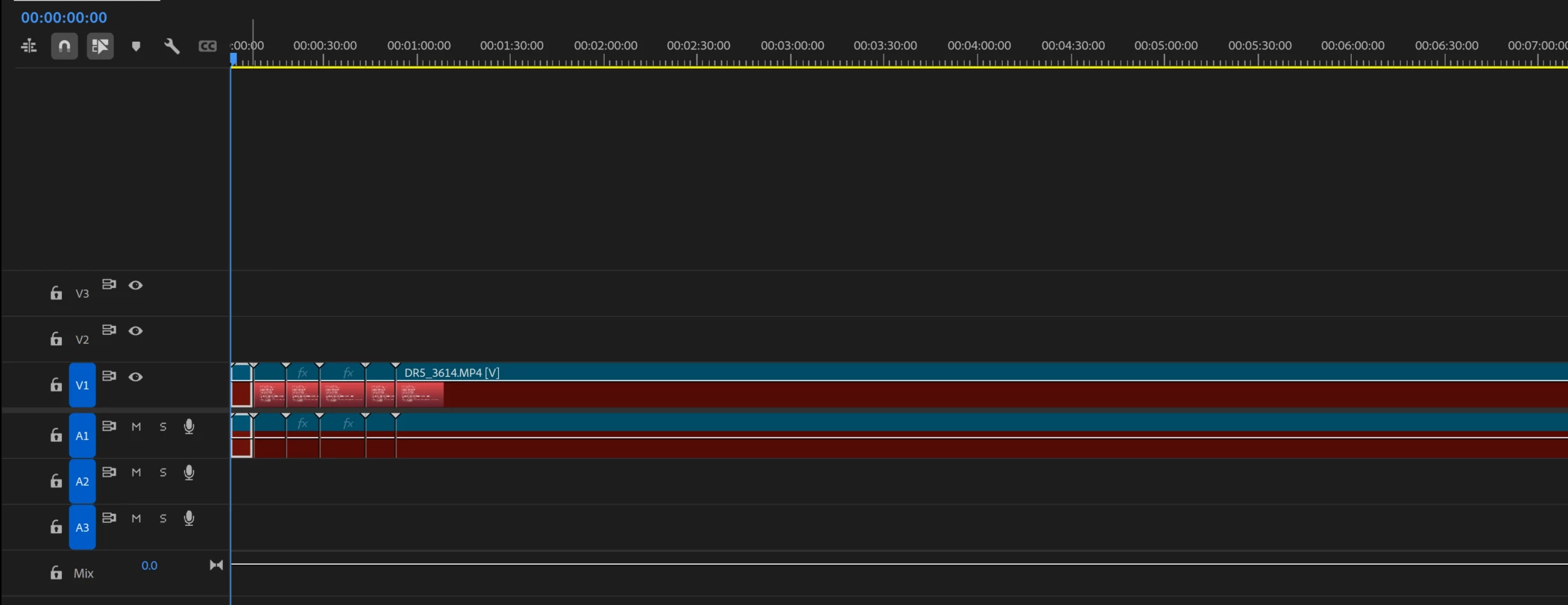

Hi @victor_1804 -  Are you using a production? the error related to media references makes me think thats how you have this project set up.  At first it sounded like the HEVC codec was bonked, but now looking at your timeline I can see that the files are loaded with video and audio, but they are offline.  I haven't heard of the canon HEVC activator, that could be causing the issue can you try and uninstall that.

When I go to find the file (as it says it’s missing as its looking at another location), I get this:
When I try the link media option, I get this:
This is how the files appear on my timeline:

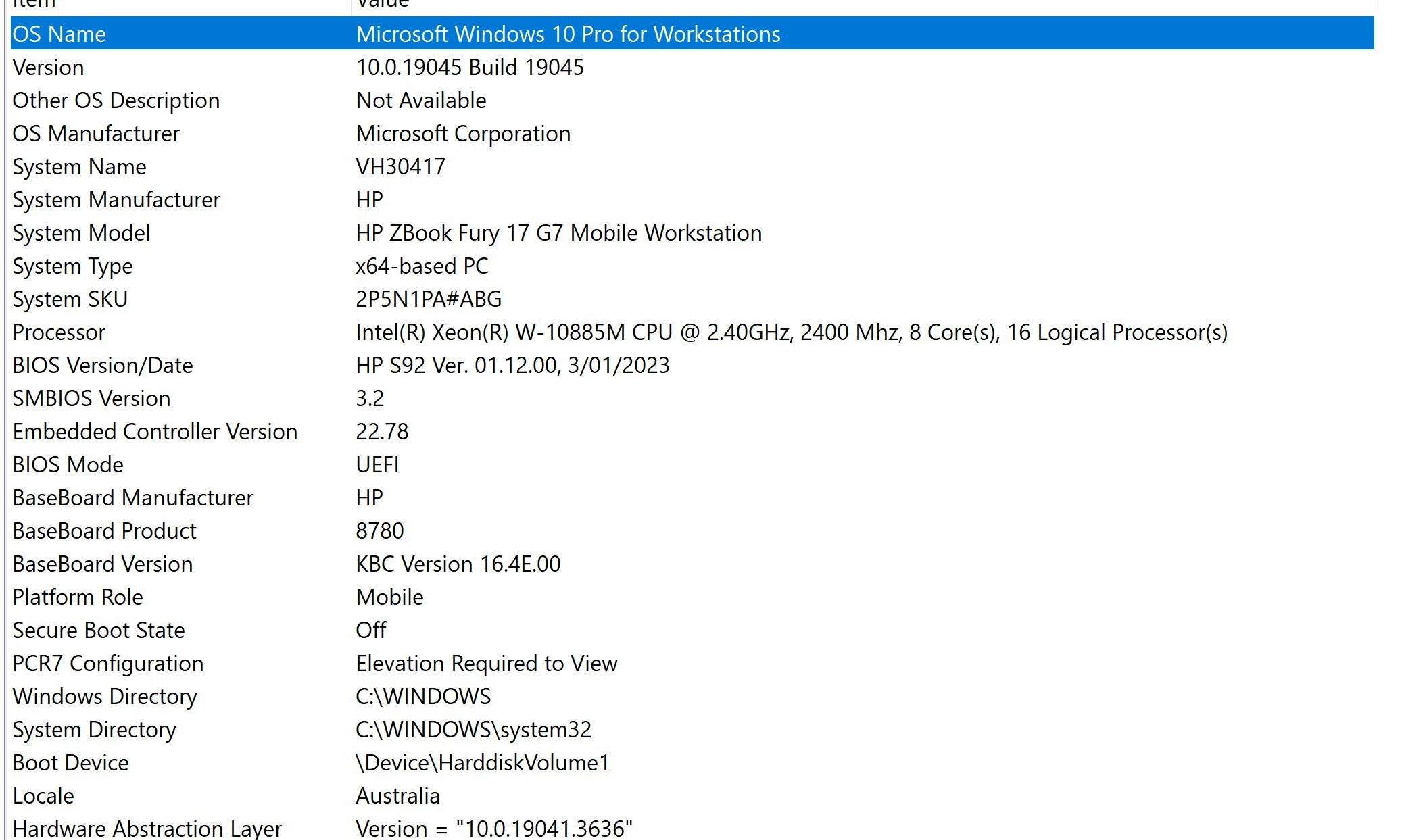

  • Operating system - Windows or macOS, and which version of those operating systems?
Windows
  • System Info: CPU, GPU, RAM, HD:
