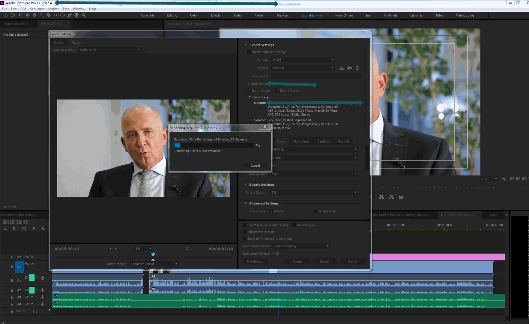

    September 16, 2016
    I´m having the same problem! And to bring it to the top;
    I´m rendering 2sec of Footage!
    Here´s a screenshot to proof whats going on here;
    Btw;
    8* Xeon E5 3,6
    32GB RAM
    Quadro K4000
    Thats really not acceptable!
