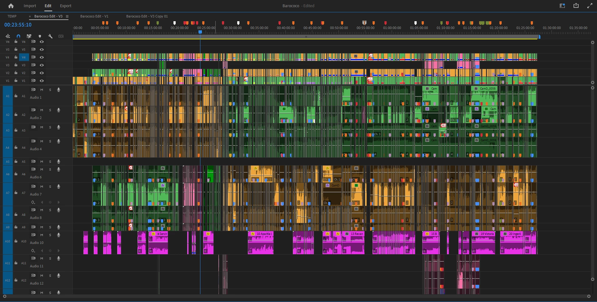

The issues that I ll be describing below have been happening for years now but on this particular project they really got on my nerves so i decided to outline them, maybe there are workarounds or some solutions.
1) When the sequence gets somewhat large (10 audio tracks, 1h 30m length) and with multiple audio tracks scrolling (both vertical and horizontal) in the timeline becomes really sluggish and choppy.
As I zoom in and less elements are visible in the timeline it gets better and better until it becomes "real time" again. This is because of all the little rectangles and cut lines that premiere has to draw I would assume? But is it so taxing on the system that it gets almost unusable?
It makes navigating a bigger edit an ordeal.
2) When zooming in an out with multiple audio tracks and cuts sometimes the waveforms dissapear and it takes a while for them to come up again. sometimes more than 15 seconds.
This again hurts my speed if i need to see waveform up close so I can compare multiple tracks or sync them by visually comparing the waveform.
I have to wait everytime for the waveform to be redrawn.
3) Aside from the waveform having trouble being shown sometimes when zoomed in and starting playback the timeline indicator won t stop and it will continue going on by its own until a random set of seconds have passed. Again, this happens at higher zoom values, If I zoom out about 50% I don t remember this happening.
4) the newest thing that I found out today was that right clicking a sequence in the Project panel won't display the menu instantly if that sequence is more complex.
It takes about 10 seconds for the right click menu to appear on a crowded sequence as opposed to instantly when I have just couple of tracks and elements in another one. I wanted to access "sequence settings" by the way.
This is just frustrating.
This is what a "crowded" sequence means to me and the one that I used in all of the examples above.

You make valid points and I understand where you come from but in this situation the problem is Premiere not how powerful the computer is.
I've opened the project on a friend's workstation, even more powerful than my laptop, and it is identical. Slow scrolling of the timeline when zoomed out, 3+ hours of render time in media encoder at least waveforms look like they load a bit faster when zoomed it but the problem is still there.
So not everything is linked to how powerful the computer is.

I'm working on a laptop, but its on steroids, 11gen dekstop version i7, 32gb RAM, 3070RTX with the biggest wattage possible for a laptop, but i'll check on a buddy s workstation just to be sure, although as I've said this has been going on for years and my laptop only has almost 2 under its belt :).
So this is just how it is, Premiere can't work well with larger sequences...:(
