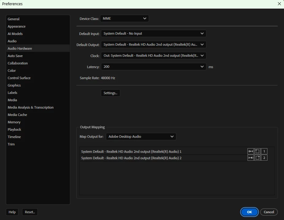

Audio hardware is set to

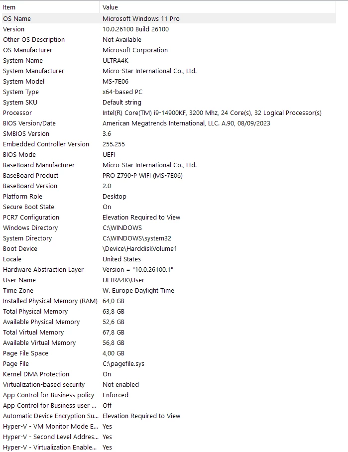

System hardware, operating system:

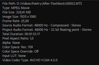

Canon Legria HF S200 camera
July 10, 2025

Thanks @Charles38967273k665.  Can you give me more details about the mts files?  What camera are they from? What are the clip format settings?  We are currently tracking an mts issue, but because your audio is fine, I'm not sure it's the same. Any additional information you can give us is helpful.
July 9, 2025
.mts files
