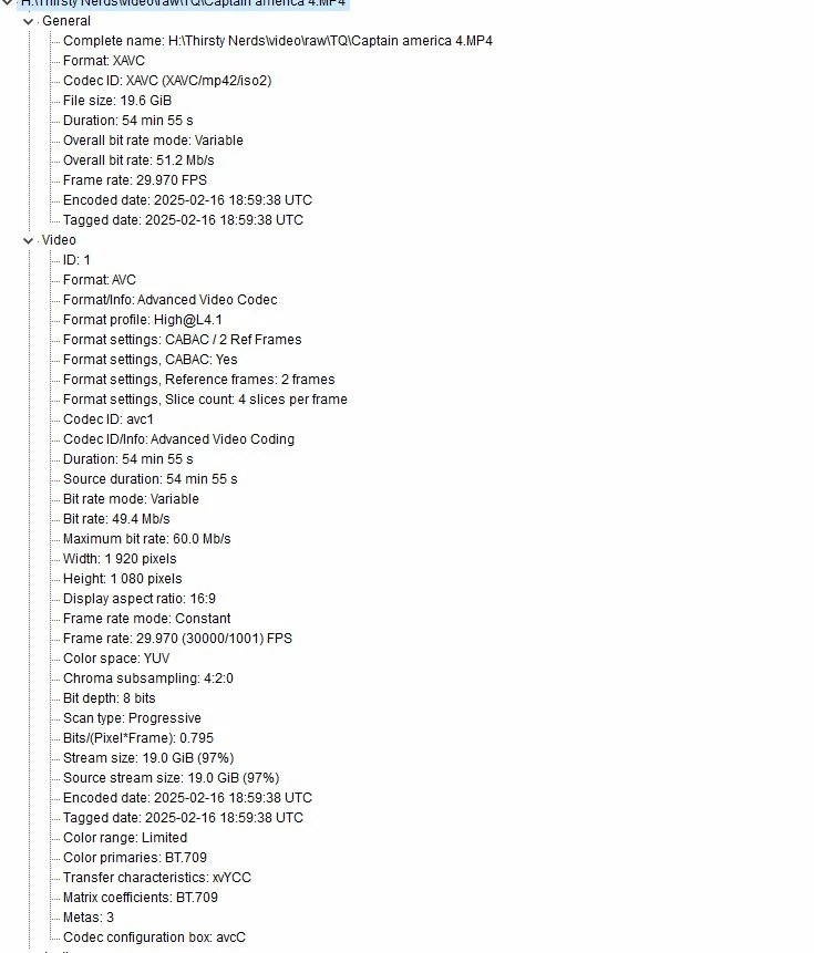

MyerPj
February 18, 2025
Take a look at the link: Info needed for a bug report
We don't know anything about your footage. Phone, camera, screen video, etc.
You can use the free MediaInfo program to get info on your clips. Get the program from the link below and using the 'Tree' view post a screenshot of your clip info: https://mediaarea.net/en/MediaInfo/Download
February 18, 2025
Ok.
