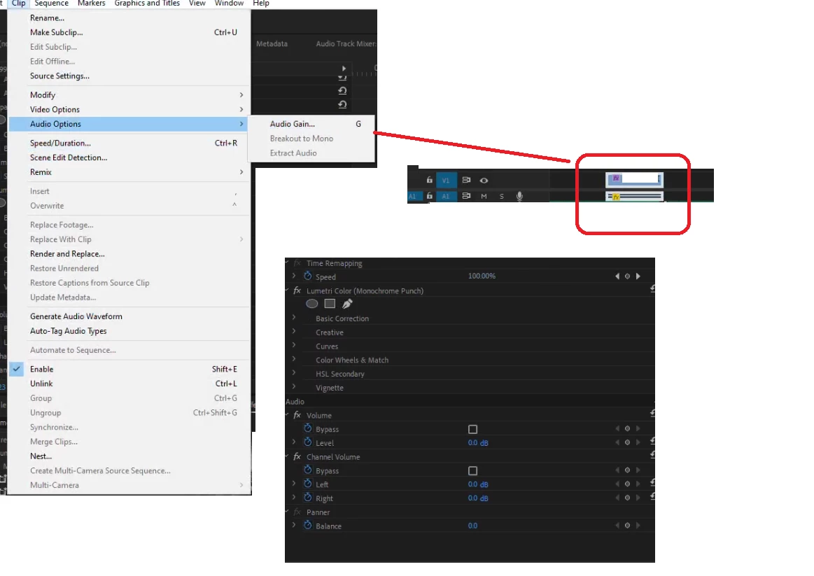

Where can I find the values of Modified Audio Gain on the Effects contols?

I selected few clips and went to audio options and audio gain and performed a added/reduced DBs of the clips.
When finished the YELLOW function appeared as we can see:
But when I go to the effect conrrols panels (see image), I dont see any  change in the values?I can only cancel it if I do a ctrl+Z/W?

Besides what Mike said, if you want to change the Gain, either use the Audio Gain dialogue box again, or you can use [ or ] to increase or decrease audio gain by 1 db. This will work with all selected clips.

https://helpx.adobe.com/premiere-pro/using/adjusting-volume-levels.html
Gain is independant of the 'Volume' levels.
If you hover over the clip - it will tell how you much gain is applied in the tooltip.
