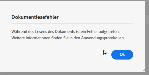

Moin, wo finde ich das Anwendungsprotokoll in Rh.
Der Import von eines Word Dokumentes hat nicht funktioniert.

    Jun 20, 2022 11:57 AM UTC
    Hi, versuchs mal in diesem Ordner: C:\Users\<user-name>\AppData\Local\Temp\RHTMP

    Jun 20, 2022 7:53 AM UTC
    I think it will be the log for the generation. I am not aware of a separate log. Try what I suggested.
    Anticipating what might be your next question, how to find the rogue topic, it seems to be time for the old divide and conquer approach.
    In the new UI the content of the output is controlled by what is in the TOC so create two copies of your TOC and delete different halves. One should work and one should fail.
    Assuming one half only failed, create a copy of it and again delete different halves. By repeating that you should narrow things down to the topic(s) giving grief.
    If both failed, you need to create smaller and smaller sections.
    It usually works.

    Peter Grainge
    Jun 20, 2022 7:34 AM UTC
    First of all there is a German version of the help.
    https://helpx.adobe.com/de/robohelp/user-guide.html
    It should be accessible from the Help menu.
    It helps if you post all in German or all in English, one being better for you, one being better for me as I do not speak any German. The translate feature on the forum cannot cope with two language replies. I believe the German word in the last post means "log".
    If RoboHelp fails to generate the log should be accessible by right clicking the preset.

    Jun 20, 2022 7:39 AM UTC
    google tranlation says application log

    Jun 20, 2022 7:10 AM UTC
    Where do I find the Anwendungsprotokoll?
    Thats the Problem

    Es ist die Version 2020.7.46
    Gibt es deutsche Dokumentation?
