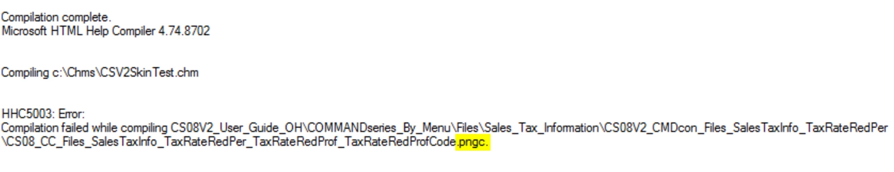

Captiv8r
Mar 17, 2017 4:47 PM UTC
Hmmm, in looking at the image supplied, I'm wondering if the issue isn't simply the naming of the image file. Note that it doesn't end in PNG, but PNGC.
Cheers... Rick
Peter Grainge
Mar 17, 2017 5:19 PM UTC
Good spot Sherlock.

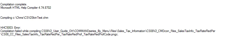

I do keep my source files on a network drive. I never really had trouble generating online help with the files being on the network, except an occasionally missing image. I moved my files to my desktop and created a new project and linked the same files to a new project and generated the help the same way I did before. And the project wouldn't compile and this message was in the Output View:
I assumed that perhaps the file path was too long and shortened it a bit, and regenerated the project. The project generated this time, but the formats/images were still missing for the same topics so I don't think the network is affecting it as it does the same thing even when the source file is on my hard drive.

Peter Grainge
Mar 17, 2017 3:12 PM UTC
That path does look very long. My next trial would be to move the project locally just to prove it is not a network issue.
If that does not succeed, make a copy of the project for the next trial and drastically shorten the folder name even if they are meaningless. The point here is to disprove that path length is the issue.
