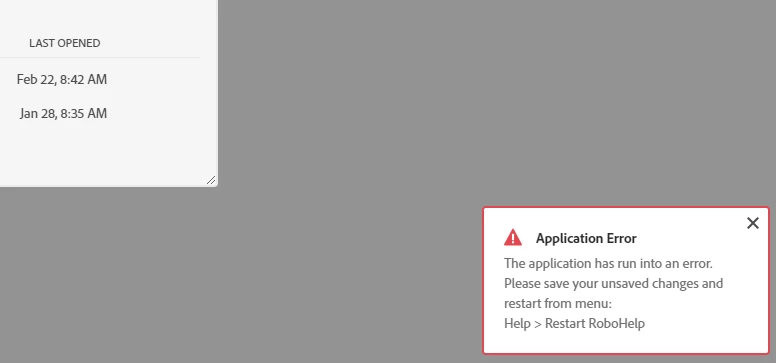

    Thanks for the additional troubleshooting, Amber.
    I've tried opening both RH 2020 sample projects. Neither one would open. I'd only get the "restart" error (see screenshot).
    RH 2020 is able to open the project I've upgraded from RH 2019. But not either of the two sample projects.
    What can I do next? Thank you!
    SCREENSHOT:
