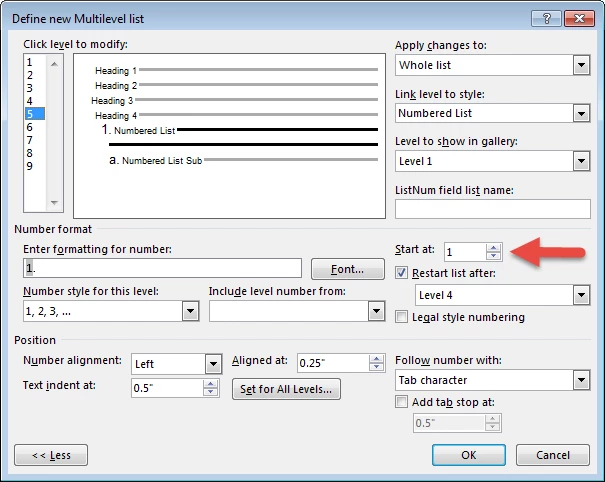

I am having the same issue. I am wondering if it has an issue with custom templates and/or multi-level lists.
  • I took a blank MS Word 2013 document and added some text. Heading and body styles were applied using the available MS Word styles. Numbered and Bulleted lists were applied using the available buttons in Word. This document imported into Robohelp 2020.4.173
  • I created a new MS Word 2013 document using our custom template. Our custom templates are setup in Word so numbered list will automatically restart after using Heading 1, 2 3 or 4. This is accomplished by definding a  multi-level list in Word (see image below). All items were styled using our custom styles. This document did not import into Robohelp.
  • I took some old documents based off our old templates. Numbered lists will not automaticfally restart after using Heading 1, 2, 3 or 4. This document imported into Robohelp.
In this situation, it appears that the failed import has to do with the the multi-level lists that were created.

Thank you for posting that. Here's the image inline using the picture icon.
It will be interesting to see if that helps the others with this issue.

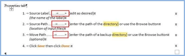

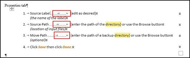

I found my problem. My document had a table in it. In one of the columns there was a TAB followed immediately by a LF character (see attachment). After removing all 3 TABs, the document processed through!
