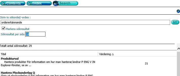

For en example:
Searching for the word "Ordererkännande" (=order acknowledgement)
you got 29 hits in the old build
URL for test:
https://webhelp.prod.pengvin.se/webhelp2020/PengVinHelp.htm#Order/Orderregistrering_Q.htm
In the build from robohelp 2019/2020 you got none result .
PengVinHelp (listen2music.se)
The content in both cases is the same
If you search for the word "Fakturor" (=Invoices) you got even worse differences
94 hits in the old build and only 4 in the new build

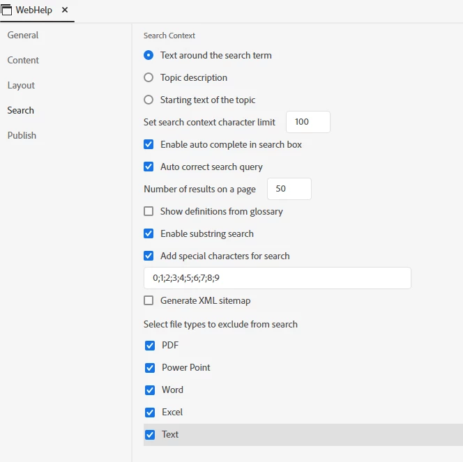

In robohelp output we have these settings for search

    Hi there,
    I have made the experience that the setting "Auto correct search query" leads to quite strange search results in German language, so maybe this is also the case in Swedish. Maybe you could try if the results look more reliable with this setting turned off.
