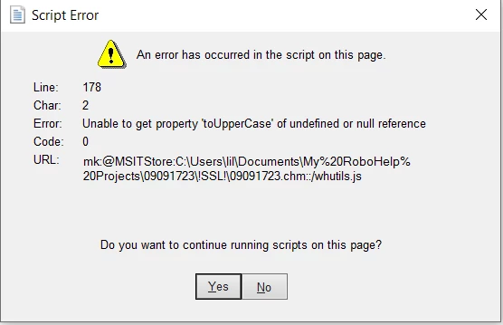

    Jeff_Coatsworth
    Sep 10, 2020 1:55 PM UTC
    Are you seeing any results after selecting "Yes"?
    You don't enable JavaScript in RH, it's in your default browser.

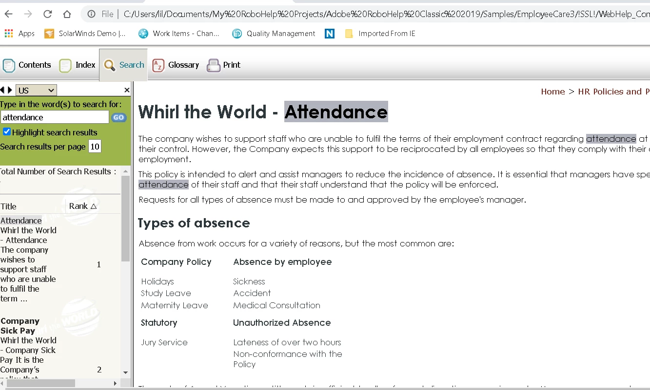

    Lily5FFCAuthor
    Sep 10, 2020 1:32 PM UTC
    If I click yes when search error appears, nothing seems affects.  Just click search again.
    How to enable  JavaScript  in Robohelp?
    Also, I don't see the search result as in the example. In my search result, it has only one on the left pane, many on the right.  I was expecting as the example search result.
    Jeff_Coatsworth
    Sep 10, 2020 1:23 PM UTC
    You need to have JavaScript enabled for the CHM to operate - what happens when you say "Yes" to the script error?
    Lily5FFCAuthor
    Sep 10, 2020 1:17 PM UTC
    Why first time run search, there is the above error message?
    Thanks for reply in advance,
    Lily

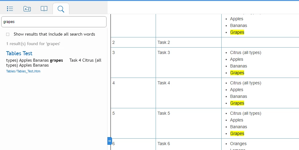

    Sep 10, 2020 1:03 AM UTC
    If the word is only found in one topic, but the word appears many times in that topic, then yes, that is correct behaviour.
    For example:
    Lily5FFCAuthor
    Sep 9, 2020 9:50 PM UTC
    Is the search function normal when put a keyword, only 1 title found with the document name on the left pane, on the right pane, there are many highlighted keyword found?
    Lily
