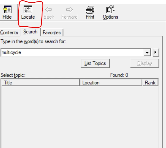

This was a great review Jared(Review at https://community.adobe.com/t5/RoboHelp/My-RoboHelp-2019-Review/m-p/10645169#M126594)and I agree with you on many of your topics! I'm pretty new to RoboHelp and I thought I'd just give it a shot and ask you a question of mine. I've just upgraded a project from RH Classic to "Re-imagined" and I have trouble getting the "locate"-button to appear in the HTML helpfile (after generating the output). I have already "clicked" the "locate"-box in the Window Settings. Is there something else I can do to make the "locate"-button appear in my output again (just like it does in the Classic version)?
I am really greatful for any answer you could give me.

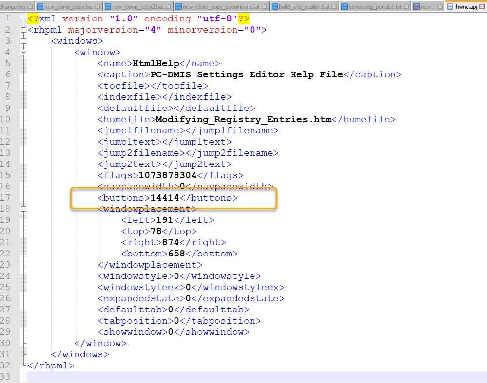

    @kajsaros1 - I don't know how much help I can be as I no longer have my RH 2019 trial. Also, it's been a couple of years since we switched from .chm outputs to HTML 5 outputs. I'm sure RH still has some kind of underlying xml file that controls the Window's properties. In Classic RH, this was in a file called rhwnd.apj. There, in the xml code, under the window's definition, they'd have a buttons tag:
    The value 12366 clears the Location check box.
    The value 14414 marks the Location check box.
    You might want to look into a similar file in Re-imagined version and and see if maybe something got messed up in that during the conversion of your project. Perhaps editing that directly will fix this issue. Good luck!

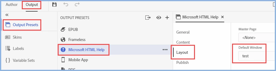

    Is the window selected in the preset the one with the locate button? I created a new window, ticked the check box and then selected the window. Locate button present.
    October 3, 2019
    Yes! This worked. Thank you very much for your help!
