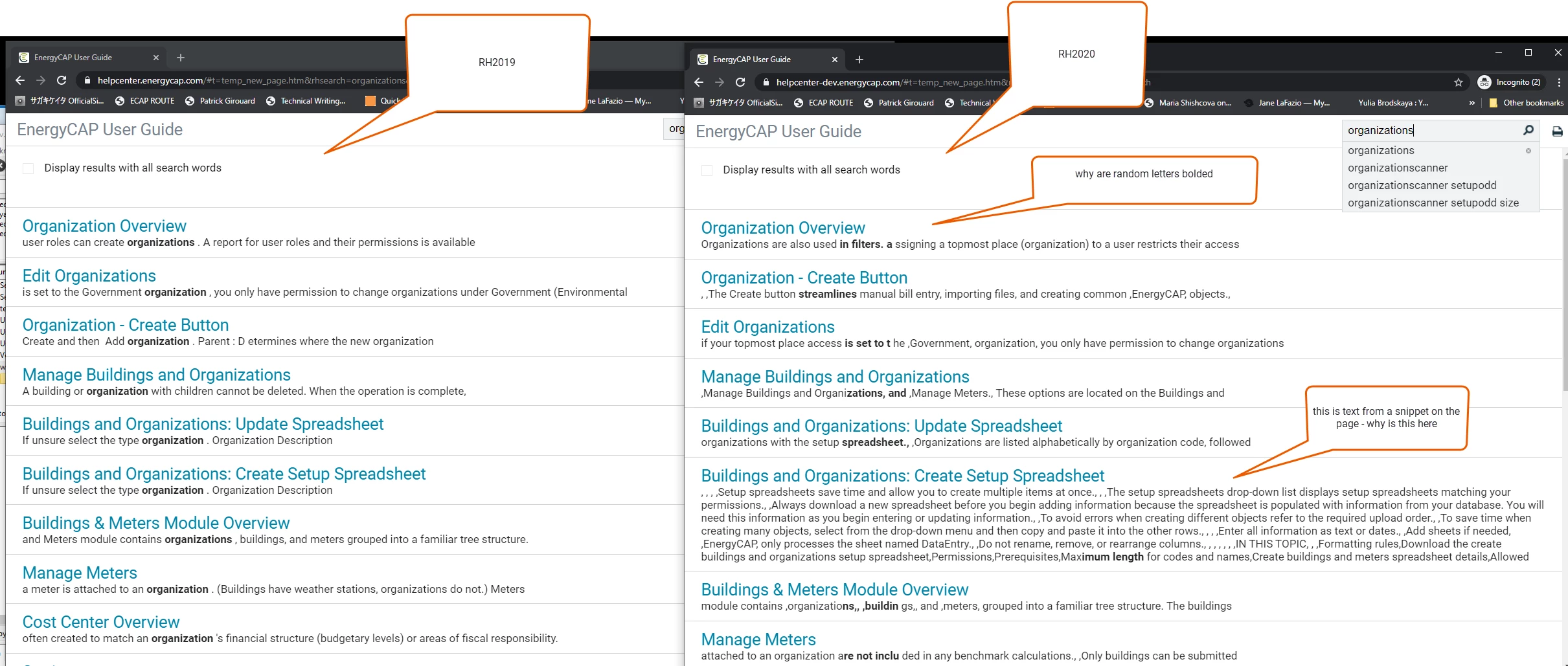

After installing RH2020 I have two odd results.
1- random letters are bolded in the search results
2- the entire text of a snippet is returned
I've attached a screen shot showing the differences.

    January 15, 2021
    The search works fine in the sample project. I created a long snippet and added to it a page. When I searched the words were properly highlighted.

    Peter Grainge
    January 15, 2021
    Open the supplied About RoboHelp sample project and see if you get similar issues there. Whilst there are some snipppets in it, you may need to add a longer one to prove the point here. It should be on your Starter Page but if not go to Documents > My RoboHelp Projects in File Explorer.
    I suspect it is a general issue and then a bug report will need to be filed. However, it is first necessary to establish whether it is general or your project.
    Try that and post back.
