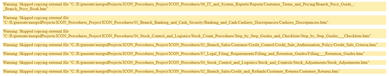

I get two types of warnings when I generate my content:
1. Skipped copying external file (all this files seem to be from a child project - so it's child to child linking)
2. Failed to copy - these seem to be images I have in the project however I could not see any errors in the live system?
Any ideas how I can identify and fix these issues?

    Okay I cleaned up my variables and generated again. I got about a dozen "skipped copying" messages.
    I used the broken links report to find and relink to the referenced topics - for historical reasons the merged projects I upgraded couldn't be upgraded correctly so I knew I'd have to fix a lot of links (I'd done most with a RegEx Find and Replace, but didn't catch all of the variations).
    So for your errors, track down all the places that reference the topic in the warning message and relink to the topic.
    I highly recommend following the setup in Peter's instructions and it makes linking super simple, and theoretically will update correctly going forward. Do practice with the demo project. It really helps to understand the underlying setup.

    You are getting the warning because the target of the link is in an output. If you look at the page I referred you to, I create such links at project level and they work in the merge.
    Check the download on my site and see how it is done.

    The "Skipped copying" message may be related to hyperlinks in variables. I suspect these will need to be converted to snippets as well, as I'm not sure the link path is being resolved correctly?
    August 18, 2021

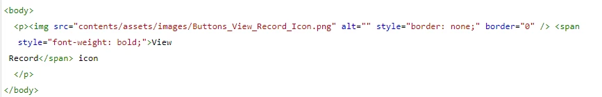

    Okay, I got the error in a small project I was testing.
    If you've upgrade from Classic, use variables, and have images in your variables, you'll get the "Failed to copy" message. You need to convert those variables to inline snippets.

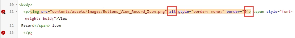

    1. Open the variable and copy the code you see.
    2. Go to snippets and add a new snippet.
    3. Switch to code view and paste the code between the p tags. I've highlighted two changes described in the next steps in the following image.
    4. Go to the end of the img tag and just before the > add a space and /.
    5. If you get an error about alt text, check for the text 'alt' in the img tag. If it doesn't have a value click immediately after alt and type =. The editor will autocomplete a pair of ". You're now done with creating your new inline snippet.
    You might also need to switch back to WYSIWYG mode and fix the image path - it might not have upgraded correctly, but my project has complicated issues that probably won't affect anyone else., so I'm going to assume the path is already fine for you. 🙂
