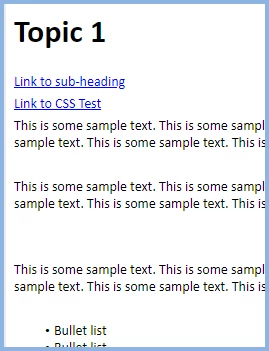

Aug 20, 2021 3:45 AM UTC
I've just been testing importing a few Word documents into Rh2020.5 and included a few blank paragraphs for testing.
Interestingly, if I import, then generate without editing an imported topic, the blank paragraphs are blank in the html sense, and are ignored (as expected).
If I edit an imported topic, then generate, the blank paragraphs have a non-breaking-space inserted, and show up in the output (also as expected, because now the paragraph is not "blank", it contains a space).
