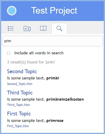

In my output, I have several topics containing the word "Primäreinzelkosten". If I search for "primär", I only get results containing exactly the word "primär", but not the "primäreinzelkosten". If I search for "primä", I get no results at all. If I search for "prim", I get all topics containing "primär", "primäreinzelkosten" and "primrose" or whatever. So the substring search seems to have a problem with the "ä". The substring search works as expected for example when searching for topics containing the word "Kostenblock". They are found whether I search for "koste", "kosten", or "kostenb".

    Peter, it is working with your sample. However, there is a difference in the settings. You are using Project Lanuage EN (UK), I am using German as project language and output language. With these settings, it is not working. I just ran another test with project language German and output language Default. This seems to be working. The problem with this setting is, that the RH-texts like "inlcude all words in search" etc. are not displayed in German but in English.

    Thanks Peter, file came through now. Could you please run a test with your project searching for "primä"? "Prim" has been working for me as well.

    The email bounced so sending it via WeTransfer. Meantime this is what I get with your settings.
