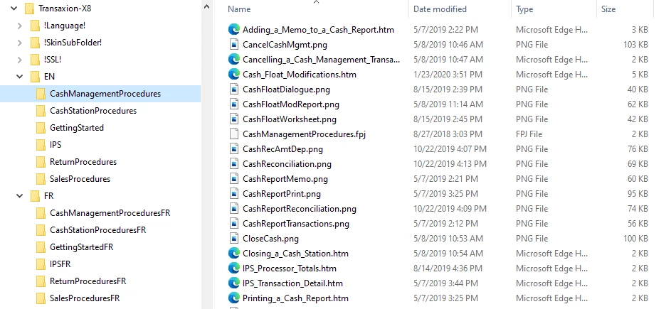

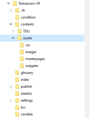

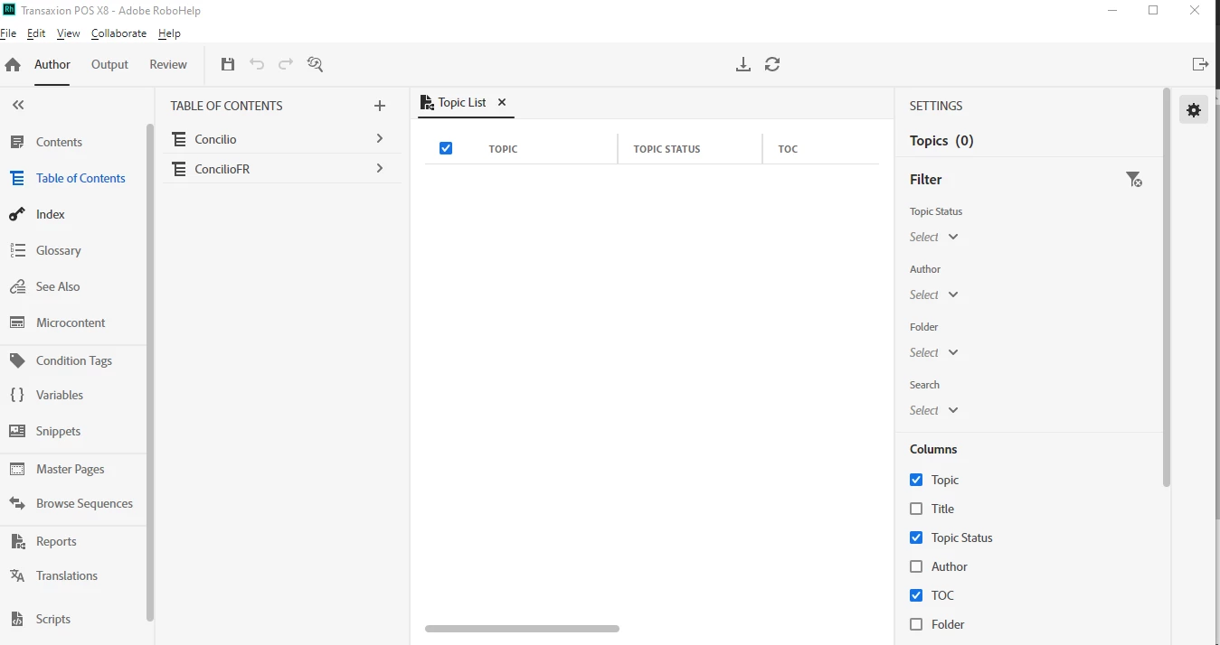

We have recently upgraded to RoboHelp 2020 and the first thing I did was to install the latest update (2020.5.71). I am trying to upgrade my existing RoboHelp 9 project but end up without any topics. All topics (and most images) are stored in sub-folders in existing RH 9 project. I cannot get a screenprint of  the RH 9 project as it constantly crashes on opening since I started running Windows 10 (which is why we upgraded to 2020). I am attaching a screenprint of the RH 9 project folders in Windows Explorer and also of the RH 2020 project folders. The project has 2 tables of contents (English & French) which are both shown in RH 2020 upgraded project but none of the content. Help topics I found online regarding upgrading classic projects to RH 2020 indicated that  topics/images in root folder would be moved to Assets folder while all others would remain in existing folders so the fact that topics/images in old project are in subfolders shouldn't be causing the issue. My project is stored on a network drive for backup purposes but I also tried to do the upgrade from a copy on my local hard drive and that didn't make a difference.

Peter shared your project with me and it turns out that .fpj file is the culprit here.
Your EN and FR folders in root are not listed in root.fpj file. I added them in root.fpj like this:
<folder>
<name>EN</name>
</folder>
<folder>
<name>FR</name>
</folder>
2019 Classic started all the topics and images fine. There are no broken links.
Then I upgraded  the project to latest RH 2020 Update 5 and it looks fine there as well.

After re-importing all my topics/images, I was successfully able to generate all versions of my output in RH 2019 Classic. However, when I upgraded the RH 2019 Classic project to RH 2020, once again all topics/images are missing - except for the intro topic for each language. This is very discouraging! I guess I can just recreate folder structure in RH 2020 and import all topics again - but I am concerned as to why this process is not working for me - even after taking the interim step of upgrading the project from RH 9 to RH 2019 Classic.
Also, I did try recreating one folder in RH 2020 to import topics/images but it appears to work differently than it did in RH 2019 Classic. In my original RH 9 project, images were stored in subfolders I created to match topic folders. In RH 2019 Classic, once I imported the topics, the images all appeared in the same sub-folder with the associated topics which was fine. However, in RH 2020, the images just appear in the "images" folder under "assets" and I am not sure if that is what is supposed to happen and, if so, if I can move them into sub-folders without breaking anything.
