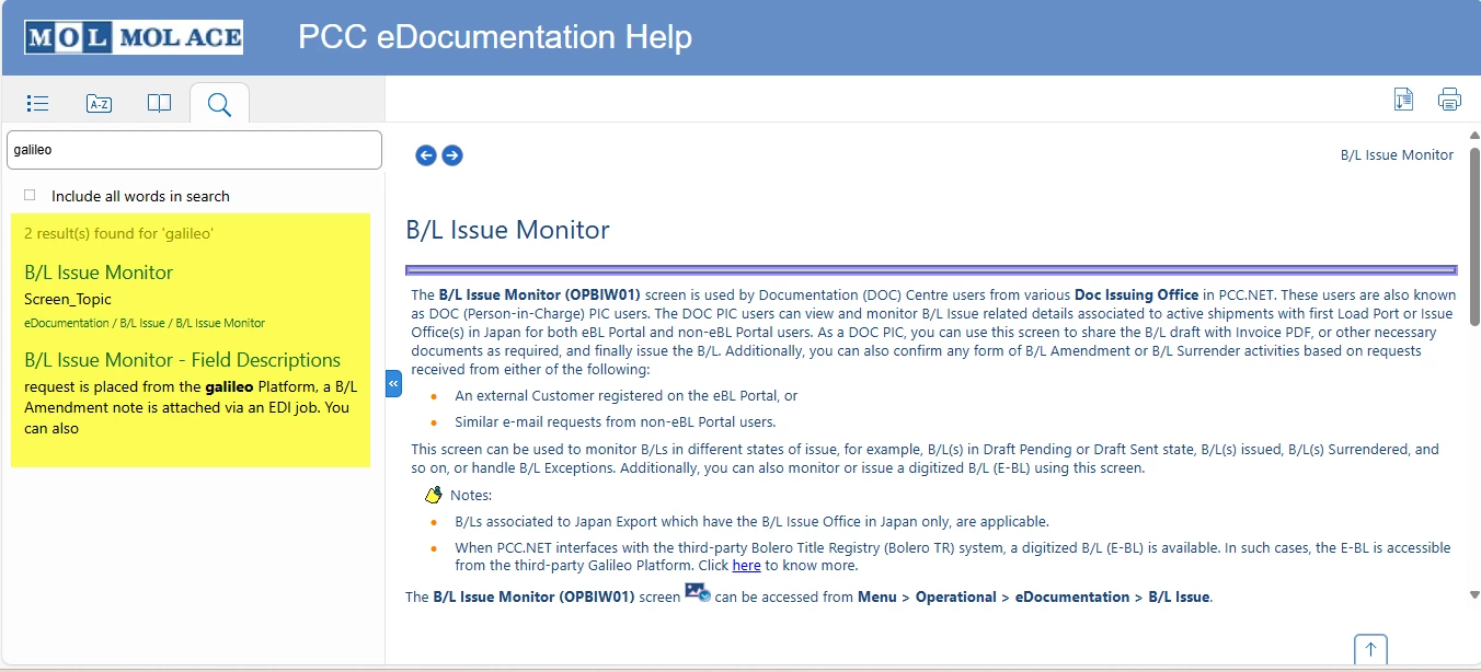

If the search result is lesser - it does work however for even around 15 results in Search the display is not coming and finally browser hangs. See two screenshots below where I have tried to depict both scenarios.
Search is successful -

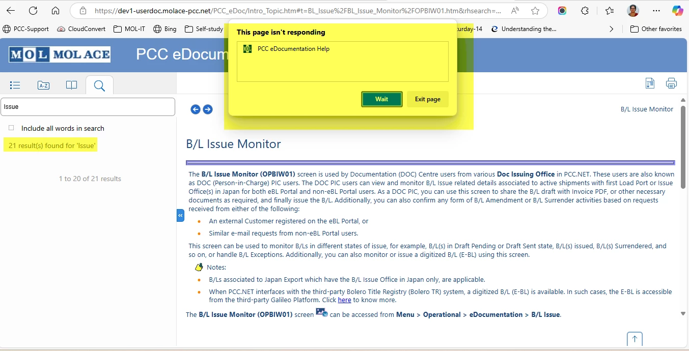

Search not working and OH browser reports to be unresponsive -
Upgraded OH works fine otherwise.

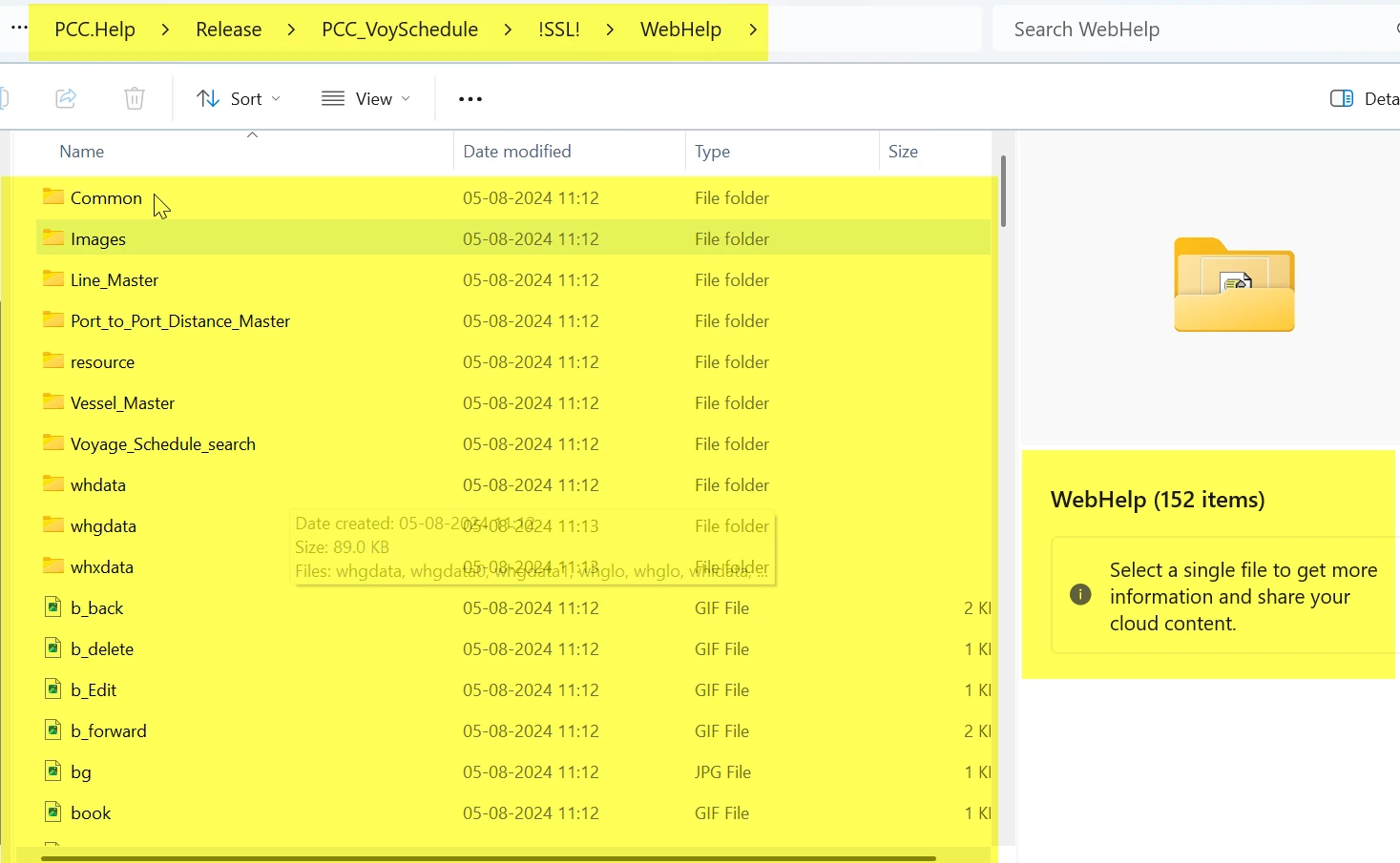

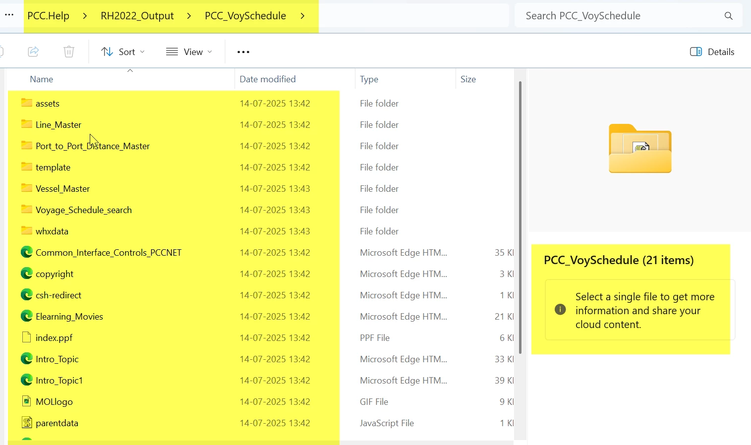

    Yes as mentioned for two of the newly tested helps we tried deleting the entire folder content and now search is functioning as desired - browser is not turning unresponsive.
    However, when we first published our RoboHelp 2022 upgraded helps using the same server location, we had already deleted the older folder content which previously included the Robohelp Classic version content. However not sure why we require to clear it again now to solve this Search issue.
    We had initially emptied deployment folder (same folder used in case of both Classic and upgraded version output files)
    - because in our understanding folder structure of assets generated in upgraded help is hugely different from assets and file organisation for previouly generated Classic version output - see below screenshots from a sample help for reference
    Classic version output folder content
    Upgraded 2022 version output folder content

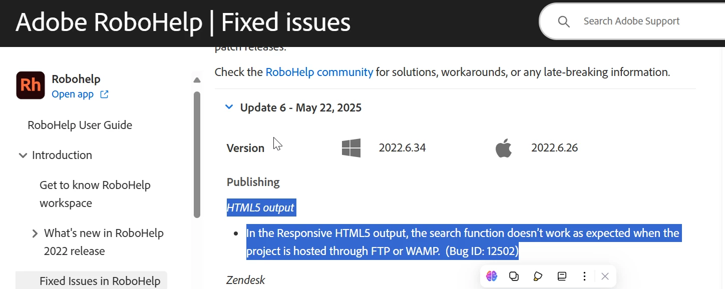

    Also note that we have also updated Robohelp to its latest Version 2022.6.0 - in which we found that (Bug ID: 12502) is fixed. However the problem of browser becoming unresponsive when search results are displayed, persists.
    However, not sure if this Publishing related bug is relatable to our issue described.

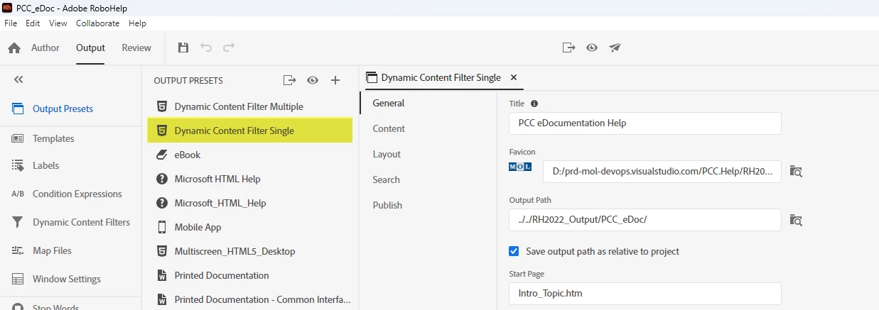

    To answer your first query - we are using the following output preset - which I presume is a HTML5 preset (see screenshot belowv as refeence)
