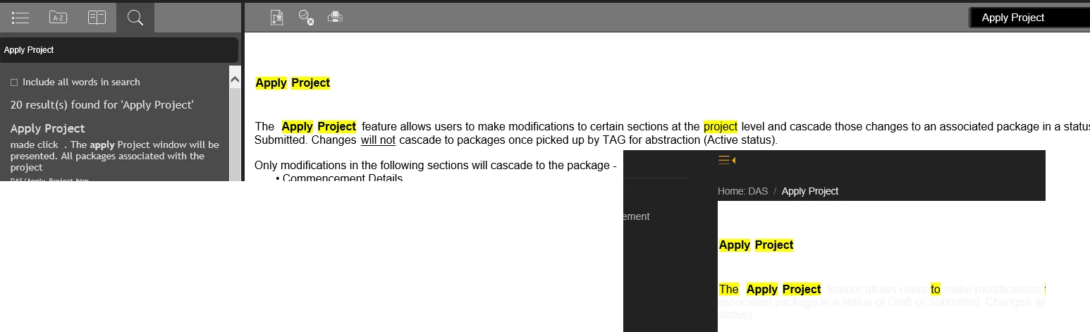

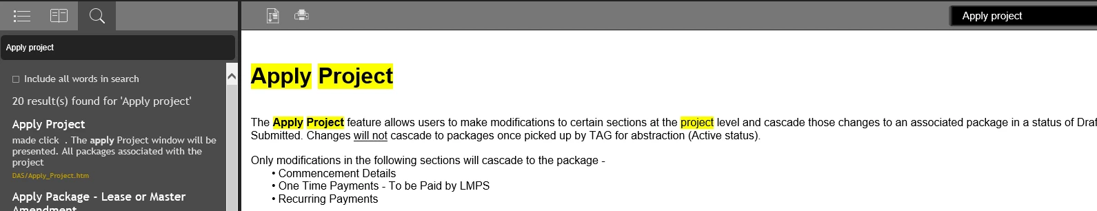

I've published a RH project in 2 formats - frameless and HTML5 - and in both instances when a user clicks on a search result, the topic heading font size changes. I've gone through all the layout settings and don't see a way to prevent this. Thoughts?
I'm using RH 2019.0.14 by the way.

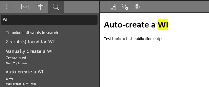

Peter I ran the test you suggested and the header was not resized in a new project. Any suggestions on how I can resolve the problem in the existing project? It's too large to recreate.

You're right....it does not occur in a new project.
