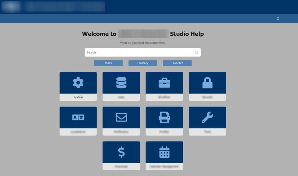

However, I now have a new idea, and I would like to build on this idea of mine, if you would be so kind as to give it a read.  Our product is to be sold as a suite, comprising of 3 different sections:  A design studio, a customer portal and an online marketplace/app store.  Each one of these three "sections" will end up having it's own documentation, and I would like to connect them somehow.  This is what I have in mind:
A landing page with 4 custom TOC images, looking something like this (ignore the images for now, they're just what I had lying around):
Now here is where I wonder if what I want will be possible.  When I click on any of the icons I want to open up the design studio's own custom icons, like so:
And the same for the other three icons as well.  Now I know this is probably not an existing feature for the layout, but I was wondering if the following could work:
1.  Create a separate project for each of the main screen's icons, in other words a new project for Getting Started, another for Design Studio, another for Customer Portal and the same for App Store.
2.  Set up "hyperlinks" on the main screen icons to navigate to the published HTML5 layout for each of the projects' index.html files.
Now, this is what I have an issue with - I can't seem to link the icon or book to a different HTML file.  I have also tried to set up a permanent redirect on the page to redirect to a different URL for now, but it's not working like it should (I use a JS command on page load).  I was just wondering if someone could help me to redirect to the correct file, or if someone has a better idea for me?
