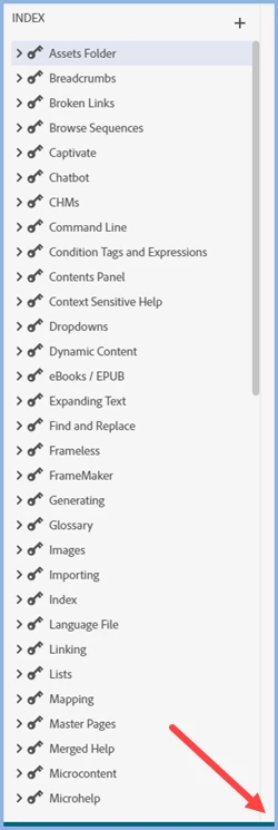

Cynthia
Please clarify a point for me.
You say the downloaded CSV has 251 lines and is incomplete. I am concluding that if you view the report in RoboHelp you are scrolling down and seeing more entries than are in the CSV. Is that correct?
Another way of checking things might be to open the Index panel and count the number of index entries you can see when it opens. Then multiply that by the number of times you have to click at the bottom of the scroll bar area to get to the bottom. That will tell you the number of keywords, not subkeywords if you are using those.
The objective of all this is to get some idea of the index size.
