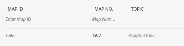

RH2020 unmerging: issues with mapfiles
Hello, I'm trying to evaluate the amount of work to migrate from RH2019classic to RH2020 and unmerge a project with 30-ish subprojects to one. One of the hurdles is the mapfiles. I followed the sequence (which doesn't talk about the mapfiles but that's ok) Peter posted here
all looking good. per subproject I had a mapfile. In RH2019 classic this looks like this
but when importing the same file in RH2020, i get this
So somewhere deep in the filestructure of RH2019 there must be a second file containing the relations.
Do I really need to fill up these topics again manually? Or is there some tric?
Why did I loose the topicnames? I checked, they are present in author/content/assets, for each ex-subproject in its own subfolder.
Do I have to merge those mapfiles to one, or can import them separately (but what about naming conventions in that case).
Can i change the order of the mappings? this will be cumbersome as they seem to be ordered in different way's from RH2019 classic  to RH2020...

AmebrCorrect answer
Feb 23, 2022 10:39 PM UTC
I haven't used context sensitive help in RH2020, so I'm not sure my knowledge is current any more.
Certainly in older versions, you could copy and paste portions of one .ali file into another .ali file.
You need to make sure the map numbers and map ids are unique in each project, otherwise you'll run into problems when you copy them into one file. Also you need to make sure the topic paths are correct for the single project location - so if the topic is currently in the root folder of your project, but you'll be moving it into a subfolder in your single project, then you should fix up the location of your topic to match the planned destination in the single project before you upgrade.
Note: I've never done this, so I'm not sure the mapping will be exact or if further manual changes will be required. Do test this on copy of your projects first. 🙂
Note2: I also haven't figured out how to use a .h file in the process. So if you get a .h file from your developers do post back on how you get it to successfully show up and allow mapping to a topic. 🙂

AmebrCommunity ExpertCorrect answer
Olivier Toebosch
Feb 23, 2022 11:27 AM UTC
Yes if I migrate a project, the topics are recoverd in the map file. If I import a map file from classic not.
My plan is indeed to either migrate all those project just for the mapfiles. en use it as a source for a 'fixed' mapfile containing all the references.
If changes are only needed in bsscDefault.h and bsscdefault.ali, i'm lucky. Looking for confirmation here. Anyone?
Any other way to unmerge mapfiles?
best regards
Olivier

Olivier Toebosch
Feb 23, 2022 10:52 AM UTC
I just did a test. if I migrate de subprojects (now I just import RH2019 htm topics straight into a new RH2020 project, the ali files is filled completely. I don't have to fiddle too much (or even not at all) in an editor in that case.
So questions remaining is if I need to merge to one file. all other questions are answered
Olivier
