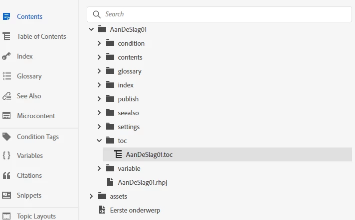

I follow these steps: create a project in RH2022.
in contents 'import folder' and designate an already migrated ex RH2019 project
All topics including toc are migrated to the content folder.
 I want to do this for more than 30 subprojects
How can I import the the toc of the newly imported 'ex' subproject?
Tried to click and drag the toc from the content dir to the toc of the main project.  a separte toc is shown in the project toc overview, but it is not visible in the output it only shows xml style text.
In fact this toc should become a section in the original first toc of the main rh2022 project. When I transform the created subtoc in a section, the title appears, but the content of the toc vanishes.
Tried to create a new section and insert childproject toc, but section remains empty in output (frameless).
this last setting results in showing 'aan de slag ' in the menu. but the not the content of aandeslag01
when I insert a toc child project, there is no menupoint to convert to section.
Actually the only route I see is to manually create the toc...
Is there a way to avoid this?
Or is it not possible to 'unmerge' easily, and do I have to keep the projectstructure 'merged'...
