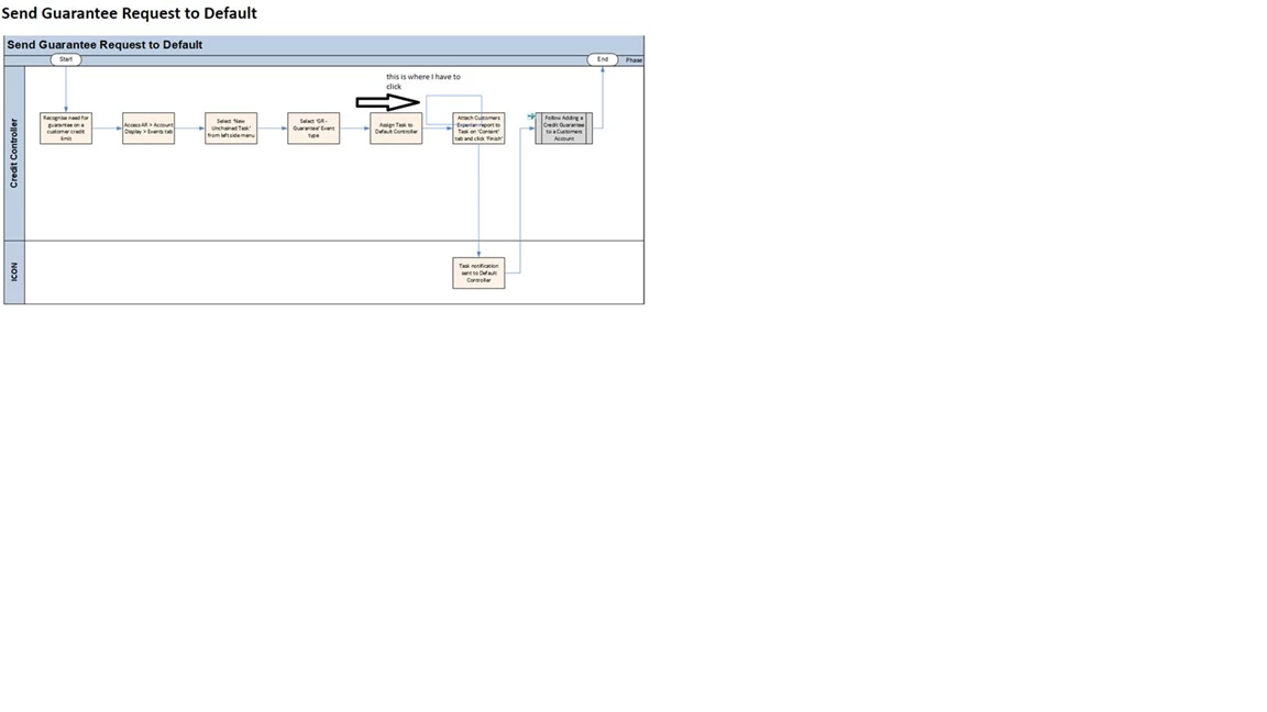

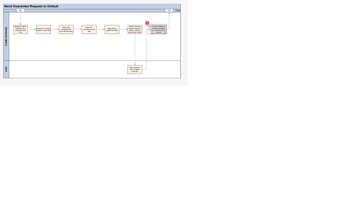

  2. Image mapping seems to be all over the place after the update. I will attach some screen shots but if I add an image map in point A and add a link against it whilst I am in the project it will stay in point A. As soon as I publish it on my drive or live system it loses the format and it goes in point B even though it should stay in point A. I've not had this issue before the update.

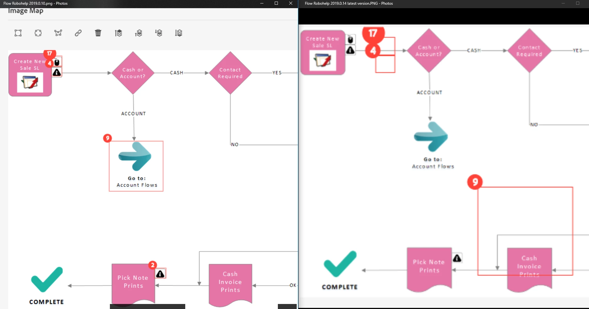

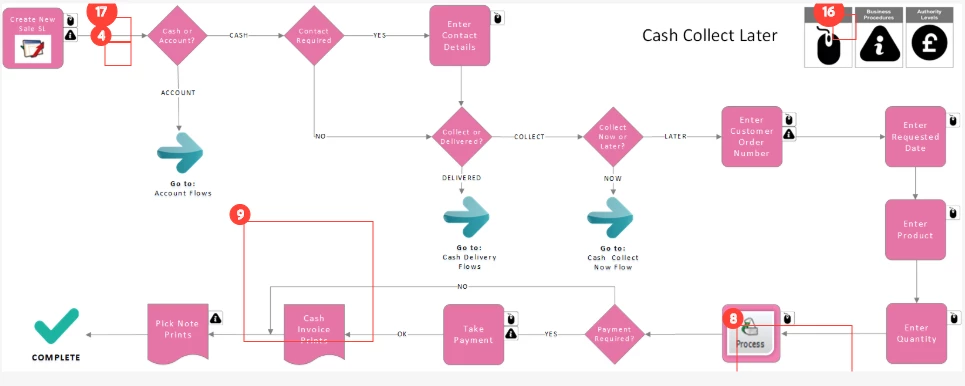

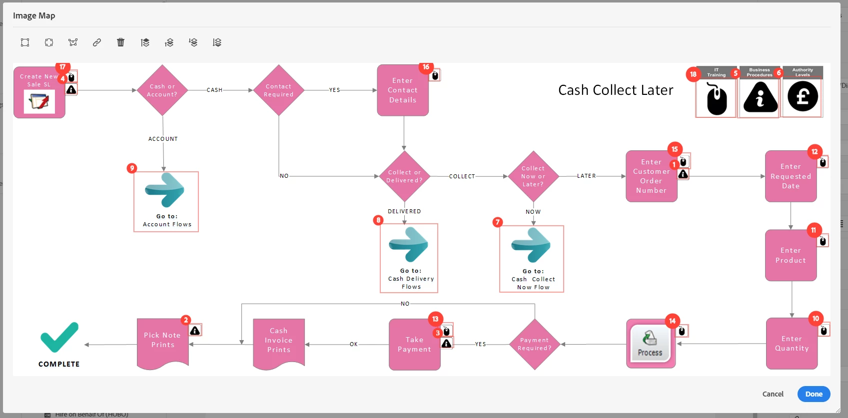

The problem is the image mapping after the update from 0.10 to 0.14. I have tried to combine the two versions in one image to have them side by side (see no. 17, 4 and 9). I zoomed in to take only 3 examples as I can understand it gets confusing. Yes, I think the problem is just the mapping - when the project is opened from version 0.10 the mapping is fine. When I open the same project in 0.14 (which is the version I currentlty have on my work machine) the mapping goes all over the place as per image below (Left image version 0.10, right image version 0.14). Note: this is not only once published; it happens as soon as I open the project in Robohelp 2019.0.14. I hope this clarify and once again sorry for any confusions.

I have another example for two different versions I store on 2 different machines. If I open poject A in Robohelp 2019.0.10 the image mapping looks as per below (as we initially designed them):
When I open same project in Robohelp 2019.0.14 the same flow with same image mapping looks as per below (even if I re-position them they will just get back to same position once I generate and publish):
