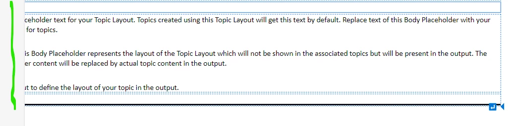

    Lija SNAuthor
    Jan 20, 2023 6:15 AM UTC
    It is not working. Below is the master page. The left side is not visible.

    It is neither freezing nor pausing.
    It's like scroll down, really down, and then scroll up. Example - I added a topic title, and let's say there are around five subheadings. Now when I try to scroll up. it will scroll up to a particular point, and I will not be able to see the title itself.
    In this case I either have to save and close the topic or switch to source mode and scroll up and then switch back to author mode.
    Sometimes the left side of the page also gets hidden. In this case too,  I either have to save and close the topic or switch to source mode and scroll to the left and then switch back to author mode.

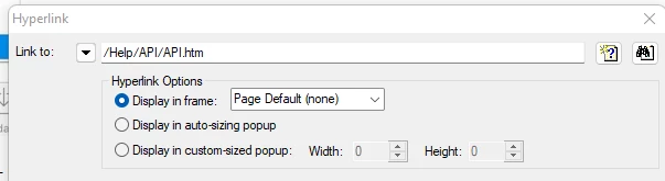

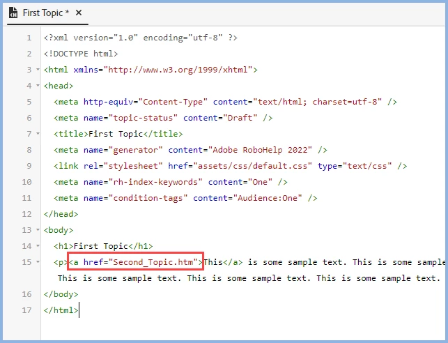

    I notice in the screenshot from Classic the link ends API.htm whereas in 2022 you don't have the htm extension. Also I think you need to be entering the link in the source code and entering an absolute path or the relative path that is required on the server, rather than on your machine, as @Amebr has explained.

    It's not always ending with .htm. There is another hyperlink like this    /Help/API.
    In the 2019 version, it worked perfectly.
    But in the 2022 version, it is not working, and the output is displaying the link as file:///help/API.
    As of now, I have updated to ../help/API.
    but there are a few more links where I cannot give ../ in front of the hyperlink, and so I need a provision to add such relative links

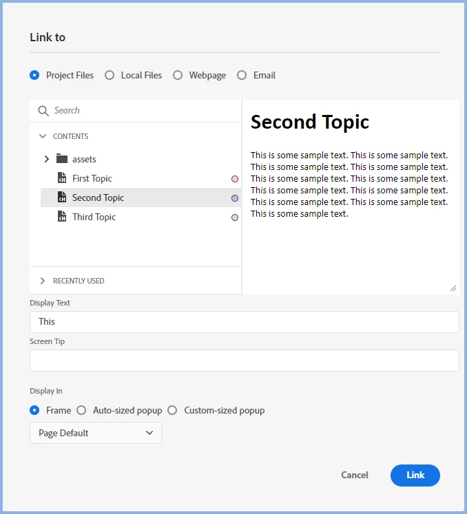

    Surely it must be ending with some extension?

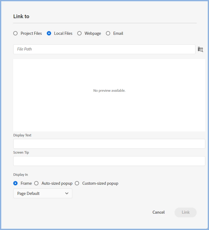

    Here I have created a link by dragging a topic from the contents panel to some preselected text.
    I could have done that by using the Insert Link icon in the top toolbar (paperclip). The result would be the same.
    Note the Local Files option. You would browse to the source topic in Project 2 and that would normally create the relative link you want in the output.
    The problem is that the relative path between your projects is not the same on the server as I understand it. Therefore after creating the relative path, you would need to amend to reflect how it is set up on the server. Personally I would set up my source projects to reflect what is on the server.
