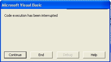

I was really looking forward to using RH6 to produce printed documentation because I attended an Adobe seminar where the presenter mentioned that there were lots of improvements. Well, I am very disappointed. I have yet to create a print doc in RH 6 without first going through quite a number of 'Code execution has been interrupted' message boxes. With RHX5, there were quite a few formatting issues, which I hoped would be corrected, but I never got error messages like this.
I don't know what the problem is, but I would sure appreciate some guidance.

I'm also encountering this problem with RoboHelp 8 and Word 2007. Just started noticing it this week. At first I thought it was related to a language output. I was seeing it when I produced Chinese output. But it happens when I create my printed output for English.
I get the code execution error dialog over and over again:
Saw some discussion on it being related to macros enabled/disabled in Word but then found this thread. As the earlier poster noted, I tried searching my registry for  RoboPDF in the registry. No hits found. I checked my addin list in Word and I didn't see the Robohook.WLLs listed. I did find RoboHook.wll in the Adobe\Adobe RoboHelp 8\RoboHELP\Startup folder. But there was only instance of it, so I didn't touch it.
I checked Add-Ins in Word and found that the RoboHelp Word COM Addin was disabled. I re-enabled it  in Word and restarted Word. Also restarted RoboHelp. No change. Same error message occurs.
Any thoughts?
Jun 22, 2012 9:56 PM UTC
Well, rebooted my PC and now the problem seems to have magically gone away. Weird. I wonder if that's what solved Mary's problem too. When she rebooted, the problem went away.

Jul 18, 2007 1:07 PM UTC
Bless you all! Thank you so much for your help. The problem is solved.
I'm not quite sure what exactly fixed the problem, but here is what I did today. I tried some of the other suggestions yesterday and none of them worked.
I removed all references to RoboPDF from the registry. I checked my addin list in Word and I had two Robohook.WLLs listed. I removed one of them. The other could not be removed, so I figured that was probably the right one.
I rebooted. The problem is now fixed and I am soooooo happy!:)

When you generate to printed output, Word is opened. The message indicates the failure of a auto executing macro to run when Word starts. This can be caused by corrupt add-ins which are loaded when you start Word.
What add-in do you have in Word. The wrong version of Adobe pdf maker has been known to cause this problem in the past.
As the error message relates to VBA, I think the problem resides with Word more than RH.
As a precaution, I would also clear down the files in your Local Settings\Temp folder. There will probably be a few written during your attempts to create the output. This could lead to a corruption of the document. Temp files are known to cause document corruptions in Word.
