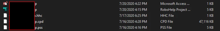

    That screen shot show my most recent files.  The 16th is when the issue began.  I had our help desk restore the xpj file from 7/14 (current one was showing 7/15 last edited) and still had the same issue.  Are you saying I should remove the CPD file only and then try to open the XPJ file again?

    If the topics open from File Explorer and other projects open, you could try deleting the failing project CPD file and then reopening the project.
