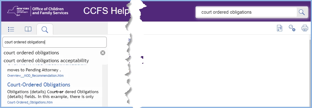

Hi Folks,
Forgive me if this is brief in detail, but as is often the case, I have inherited a project I know very little about.
My organization is in the process of moving a help system for an enterprise level proprietary computer system from RoboHelp Classic to RoboHelp 2019.
The content and structure of the help topics is virtually identical in both systems. However searching is producing markedly different results.
In the old system (RoboHelp Classic), I can search for a help entry by title and it is the first item returned. When I perform the exact same search in RoboHelp 2019, the results are wildly different, and not at all helpful, and almost never contain the entry that I searched for.
Can anyone point me in the right direction? Is this an indexing issue? Or are there search settings in RH 2019 that I need to tweak? Any assistance would be appreciated as I am stumbling around in the dark at the moment.
Steve

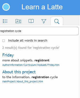

    In Learn a Latte I entered text to two topics that I knew wouldn't appear in the projects. In one topic I entered "registration cycle" without quotes and in another topic I entered "registrant" without quotes. In the preset I turned off "Auto correct search query" and  "Enable substring search", thinking those might have some effect on "fixing" "incorrect" searches.
    When I search for "registration cycle" both topics are returned even though neither 'registration' nor 'cycle' appear in one of the topics. "registrant" is bolded so I know that was what matched. I don't even know why it is listed first when it's less like the search I entered. (so that's problem #2.)

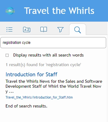

    Then I used Travel the Whirls in Classic and did the same thing. I turned off "Enable substring search" as well. This time, only the topic containing "registration cycle" was returned.

    1. search is returning topics that contain sort-of-similar words.
    2. sort-of-similar words are prioritised ahead of the exact matches.
