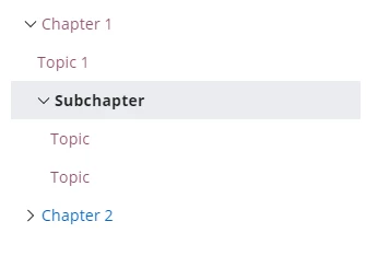

I am not able to locate where I can adjust the table of contents (TOC) in the left panel of the topic page. Specifically, when I click the topic heading (hyperlink) in the TOC the link changes color. I cannot find where I can just the “on-click” color change to select the color I want. Does anyone have any insight on where I can find this?

    The topic code you posted usually indicates the content was imported from Word documents. It hasn't typically affected the toc colouring in past versions, but perhaps that's changed with the new Frameless output?
    In two or three topics in Robohelp, switch to code view and look for that code and delete it. You might find it appears in the topic as <body link="xxxxx" vlink="xxxx"> - just delete the link and vlink text, rather than the whole tag.
    Generate and see if switching between those topics now shows the toc items the correct colours. If yes, you should be able to do a search and replace on the code to remove it.

    Sorry for the delay in posting. I worked on Peter's suggestion and posted the result, then went to work on Amber's suggestion, which took a bit longer. Amber is correct, each of the pages the TOC is linked too code in it to change the link color.
    When I manually removed the code above from the linked page the colors stopped flipping.
    Thank you both for your help and suggestions.

    April 20, 2021
    You have to remove the style definition from all of your topics. That's what causing the colour problems. The code is in each individual topic.

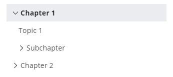

    Dean5EA1Author
    April 19, 2021
    I created a new project, as recommended. I used the the stuido skin. I added a quick TOC and attached files to the TOC items. I get the same results.
    Here is when it first loads:
    I clicke on a different TOC item:

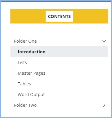

    Peter Grainge
    April 17, 2021
    You did select the new copy of the skin when you generated again didn't you? 🙂
    The reason I ask is I just created added the Studio skin to a project and this is what I see. No matter what I click in the TOC, the selected item is bold with a background and all other topics are as shown.
    If you did select the new skin, I think you next step is to create a new project with just one or two topics and see what happens there. Alternatively try it in the About RoboHelp sample project. You could also open the Compass Travel project as that uses the Studio skin but it may be a modified version.
