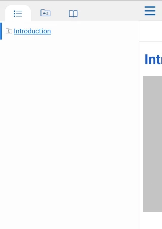

Hi! I am using RoboHelp 2022.0.346 to generate Responsive HTML output using Azure template. In the desktop view, I can see that the TOC is expanded by default in the left window. However, in the mobile view the TOC is not expanded and only the first topic is seen. The TOC expands when I click on the first topic. How can I get the complete TOC by default in the mobile view as well? Please help.
Thanks!
Kalyani.

    Mar 13, 2024 6:33 AM UTC
    Hi! Thanks for the reply! The thread you have mentioned is not exactly the same problem that I am trying to solve. I am ok with the first topic being expanded but I want the TOC to be shown completely and not just the first topic.
    This is the desktop view where the TOC is expanded by default:
    This is the mobile view where only the first topic is seen:
    When 'Introduction' is clicked it expands to the complete TOC as in the desktop view. How can I get the mobile view to show the complete TOC by default instead of just the first topic 'Introduction' using the Azure template? Any pointers would be helpful. Thanks!
