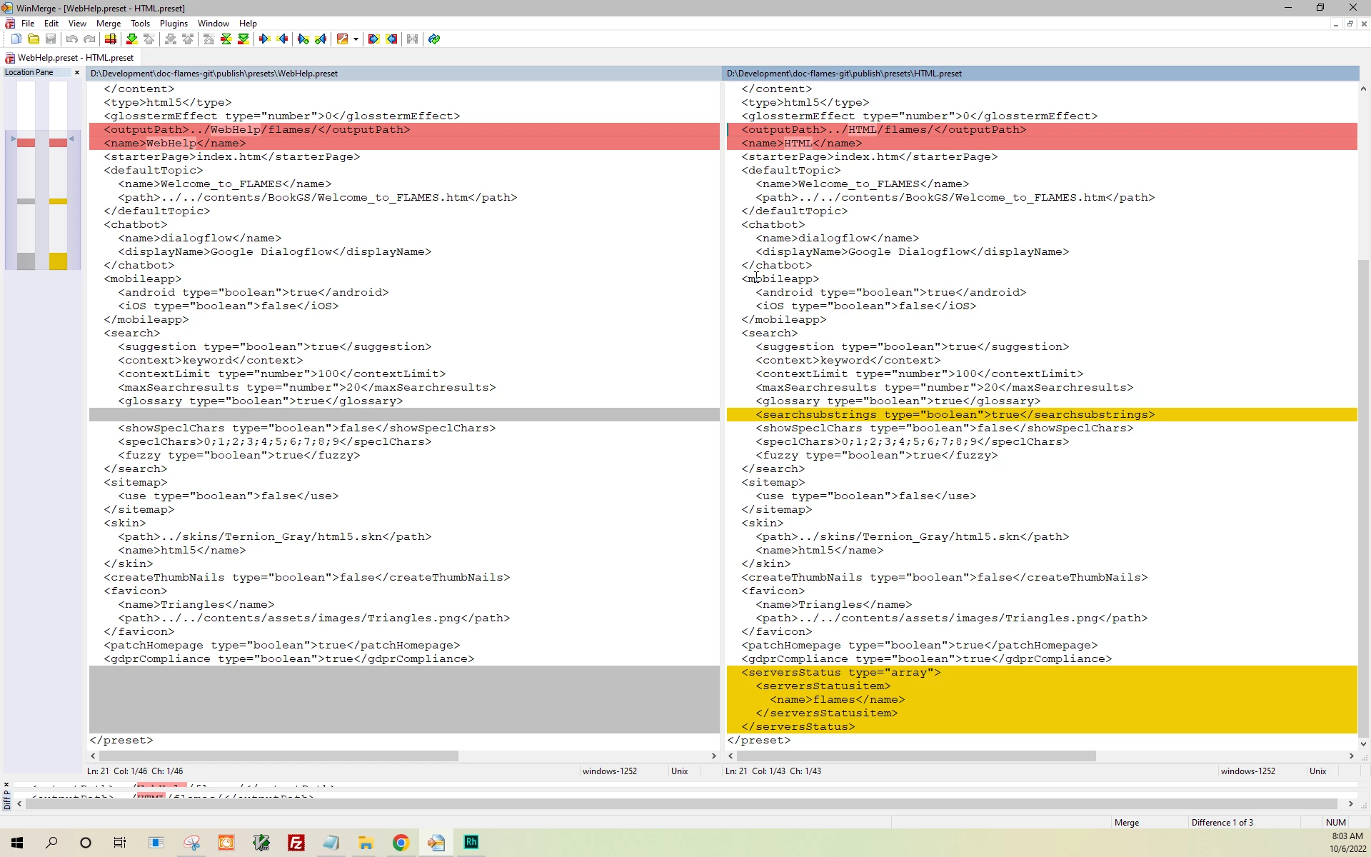

I will try some more things later; have to get back to my other (main) work. My manager was having the same problems originally too.
deniseh47762385
Oct 6, 2022 2:28 PM UTC
Did you try the last project I sent?
Peter Grainge
Oct 6, 2022 1:38 PM UTC
Well if you didn't send it, I probably didn't try it. 🙂
Where in the UI are you seeing those differences?
________________________________________________________
My site www.grainge.org includes many free Authoring and RoboHelp resources that may be of help.
deniseh47762385
Oct 6, 2022 1:46 PM UTC
The difference was when I did a Compare of the 2 files from File Explorer. See attachment on the bottom.

Your output looks good but you were probably using the DocHelp.preset and not the WehHelp.preset I didn't send you.
In RoboHelp, the OUTPUT PRESET settings look the same.
However, I did look at WebHelp.preset compared to other presets I made that work and there is a difference that is not in the WebHelp.preset. I don't know where this comes from:
<serversStatus type="array">
<serversStatusitem>
<name>flames</name>
</serversStatusitem>
</serversStatus>

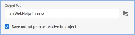

I think now the issue may something more with the Preset name and folder combination? I tried various tests today (see below) and Preset-Folder WebHelp-WebHelp is always a problem.
If you could try one more thing - create a Preset WebHelp too, generate to ../WebHelp/flames/ and see what happens.
Tests all using D:\Development project & generated files under D:\Development\<Folder>\flames folder:
Preset Folder Result
WebHelp WebHelp Bad
WebHelp HTML Good
HTML HTML Good (we may change to use this)
HTML WebHelp Bad
DocHelp DocHelp Good
DocHelp WebHelp Bad
DocHelp HTML Good
I tried the sample AboutRoboHelp project w Preset/Folder WebHelp and all is Good. However, that is a very small project with only one level of books/topics.
I took the project I sent to you, moved in the same D:\Development folder and tried:
DocHelp DocHelp Good (I sent him this)
DocHelp WebHelp Bad (Peter changed and no problems?)
WebHelp WebHelp Bad - TRY THIS COMBO
I copied project to C:\Development project & generated files under C:\Development\<Folder>\flames folder:
WebHelp WebHelp Bad

Oct 5, 2022 1:38 PM UTC
The project I sent you already had the "good TOC" (Output Path = ../DocHelp/flames/) saved in the Output preset.
If you change the Output Path to ../WebHelp/flames/, the results will be different.
Try the project in D:\Development\doc-flames-git and generate the help to both D:\Development\DocHelp\flames and D:\Development\WebHelp\flames, respectively (relative or absolute - same results).
Next, open the generated index.htm to open the help in a browser. Try these steps in both:
(1) Select the 'How to Get Started' link on the home page (or expand Getting Started book and select topic).
(2) Select the 'Systems Requirements' link (or expand TOC to Setup and Administration Guide | System Configuration | System Requirements and select the System Requirements TOC/topic).
In the "good TOC (../DocHelp/flames/), the active TOC item is highlighted. In the "bad TOC' (../WebHelp/flames/), when you select the 'Systems Requirements' link, the active TOC item is 'What is FLAMES?'. Also if you right-click the Systems Requirements TOC item and 'Copy link address' and paste that URL in a new browser window, the "bad TOC" does open the correct topic, but if 'Click here to see this page in full context', the active TOC item is not highlighted or it's the wrong topic. Trying the same procedure with the "good TOC" and the index.htm produces the correct results.
Another test with both outputs is to go to Applications Manuals | FORGE User Manual | The Basics | Working with Datasets and select the 'Datasets Overview' or 'Managing All Datasets' from the TOC. The "bad TOC" output will jump down to the FIRE manual as far as the active TOC item.
Another test is to Search for 'Generating Entity State PDUs'. Select the top result to display the topic in the main frame. Then, go back to the Table of Contents tab. The "good TOC" output selects the correct active TOC item and the "bad TOC" output does not show any active TOC item. You can even change the URL 'DocHelp' portion to 'WebHelp' and see the differences.
This is consistent and goes to show that "WebHelp" may be a reserved term. However, my 10/3/22 test to ../WebHelp/flamestest/ was a good TOC? The other 3 projects do not seem to have this same issue.
When the output is generated, all the previous files are removed before the new output is created. I have tried to remove the local and "published" intranet files, cleared Cache etc but the test/results above are consistant.
If this is the case, it's easy enough to publish to /DocHelp folder, but we'll need to "Find and Replace" all the external links in all 4 projects (and generate). Also, and more importantly, a developer will need change the way we are building our installer. Currently, the 'WebHelp' (default) installed parent folder is C:\ProgramData\Ternion\FLAMESLauncher\documentation\flames21.0\WebHelp\flames.
Since my manager and I use the same repo and project, we should have the same (C or D drive) project/output structure so we don't have to keep changing the Output Preset location or create another preset. I will be the one that will produce the generated help for our developer (and also publish on our intranet for other folks to view) but he should know how to do it in my stead. We can use the absolute path, if needed, for C or D drive.
