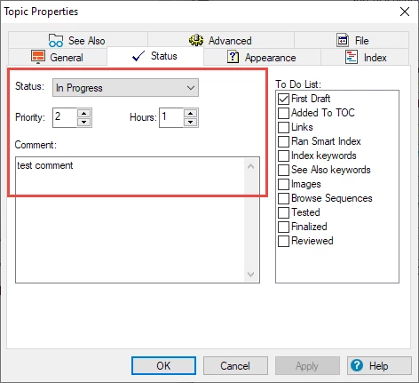

Sep 26, 2022 12:40 AM UTC
These meta tags are from classic in case that helps and should have no effect on the table of contents:
<meta name="topic-status" content="In Progress" />
<meta name="topic-priority" content="0" />
<meta name="topic-time-estimate" content="0" />
<meta name="topic-comment" content="" />
I don't know where the topic-id one comes from though. I couldn't get it to appear in Classic despite setting every property I could think of.
