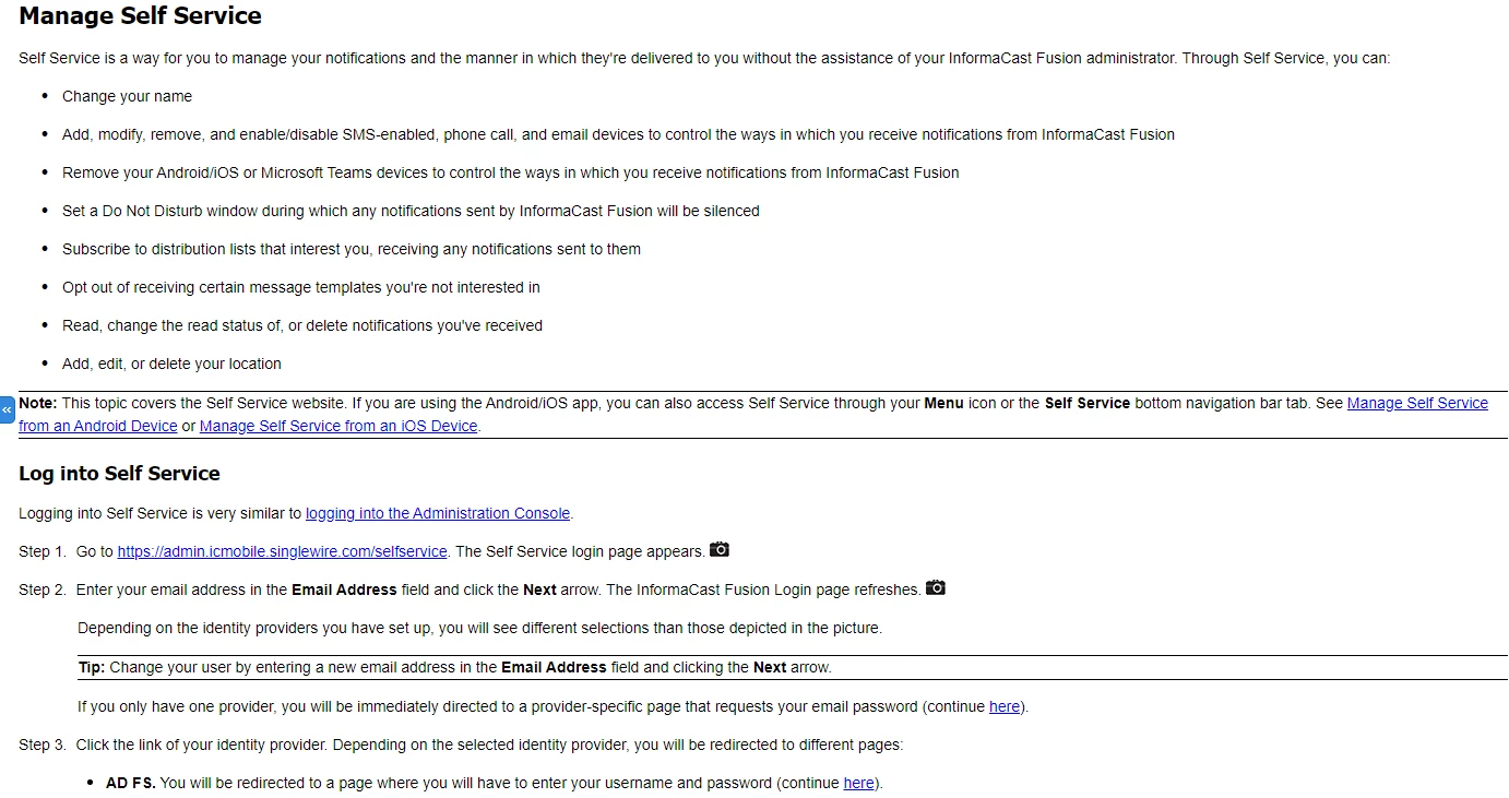

This is truly puzzling. I have a topic, Manage Self Service, that is not showing up correctly in published output. I've generated and published multiple times, and RH doesn't seem to be recognizing content-level changes I've made.

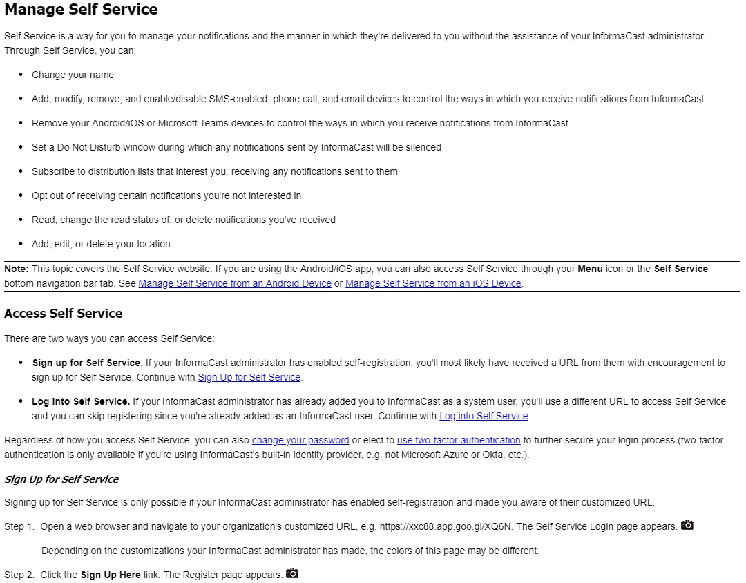

The topic appears correctly in the Output pane, and should look like this in both the Mobile and Fusion outputs:

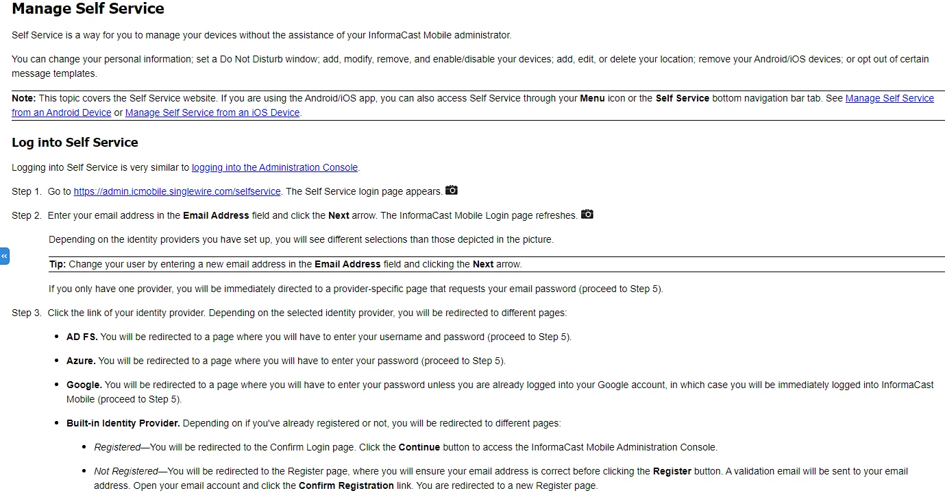

It instead looks like this in Mobile output:
And like this in Fusion output:
These are both valid PAST iterations of this topic, but not its current state.
