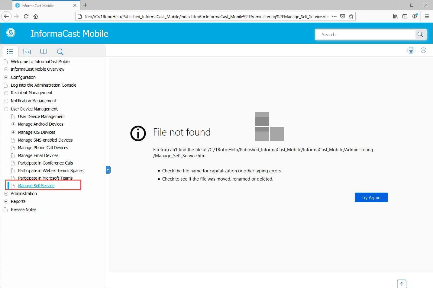

Yes, it is an upgraded, previously Classic project.
The link does show in the TOC and any links to the topic from other topics appear active, i.e. blue. Clicking them gives you the page not found error.
Other topics with the same topic-level tag are appearing just fine. RH just isn't publishing that topic.

December 2, 2020
Well, until you had me delete everything and publish from scratch, I didn't know that the topic would be missing. It seems as though the project had kept different, older versions of the topic in the two output locations' folders that it was using each time I republished. When I deleted everything, that's when I was able to see that it wasn't republishing that topic.

December 2, 2020
Gotcha. OK. I deleted all the files in my output location for the Mobile output, regenerated it and published. When I opened index.htm in both Chrome and Firefox, that topic is now missing. When I check the HTM file's location in the output location, it is indeed not there.
