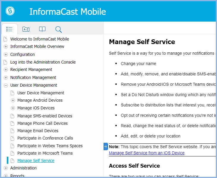

This is truly puzzling. I have a topic, Manage Self Service, that is not showing up correctly in published output. I've generated and published multiple times, and RH doesn't seem to be recognizing content-level changes I've made.
The topic appears correctly in the Output pane, and should look like this in both the Mobile and Fusion outputs:
It instead looks like this in Mobile output:
And like this in Fusion output:
These are both valid PAST iterations of this topic, but not its current state.

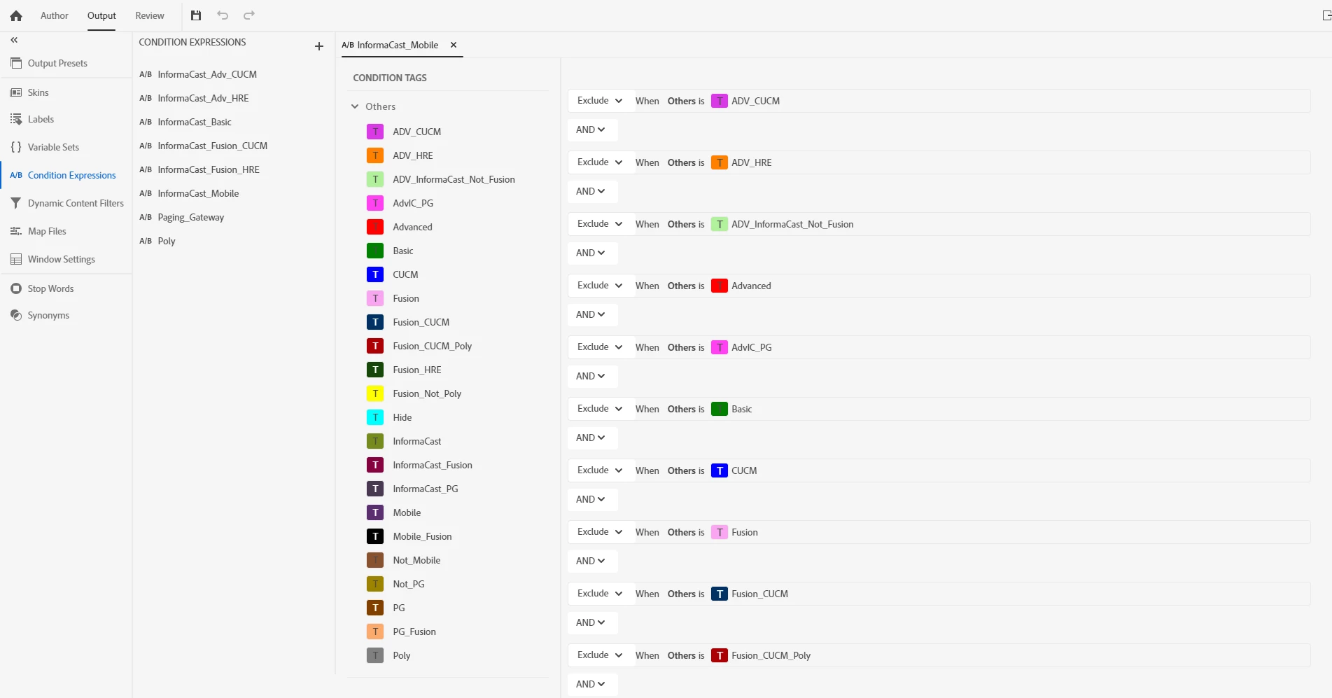

Dec 2, 2020 9:12 PM UTC
Yes, it's in both outputs' TOCs. It presents like this:
The expression looks like this:
