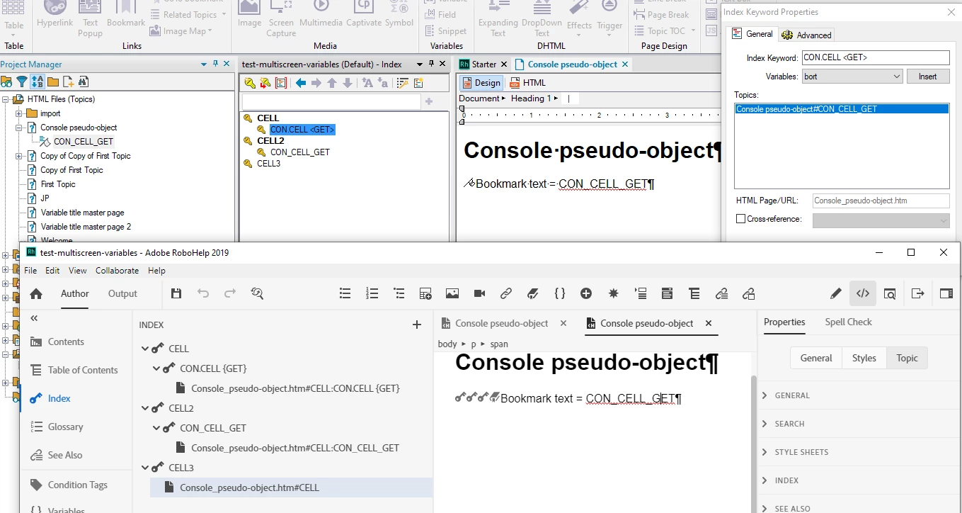

I can confirm the behaviour you're seeing. I don't think it copes with subkeywords
I set up a topic with H1 and topic title as "Console pseudo-object" and a bookmark "CON_CELL_GET".
Then I set up a keyword and subkeyword (dashes to simulate the indenting):
CELL
--CON.CELL <GET>
CELL2
--CON_CELL_GET
CELL3
Then I selected the subkeyword CON.CELL <GET> and dragged the bookmark from the project manager into the "Topics for" section of the index.
I repeated for CON_CELL_GET (to test if the problem was special characters and spaces) and CELL3 (to test if it was subkeywords).
On import, I found the following:
1. Angle brackets in the index were changed to curly brackets. (If I manually create a new subkeyword in RH2019 New UI, the angle brackets remain.)
2. There is a new index key icon in the topic, and the text in the html code matches the "bookmark text" displayed in the index. (It describes the keyword and subkeyword structure. It reminds me very much of the index coding we used to have to do in Word in the WinHelp days).
3. The keyword CELL3 was the only index item to upgrade correctly and link to the topic. It does get a "new" bookmark because of the way the "id" property works (no duplicate ids allowed in a web page).
Do note that in RH2019 New UI and RH2020, linking to a bookmark results in the topic displaying in the index as "filename.htm#bookmark_text". There's an item in the tracker requesting the topic title display and the ability to edit the title displayed in the index. https://tracker.adobe.com/#/view/RH-8071

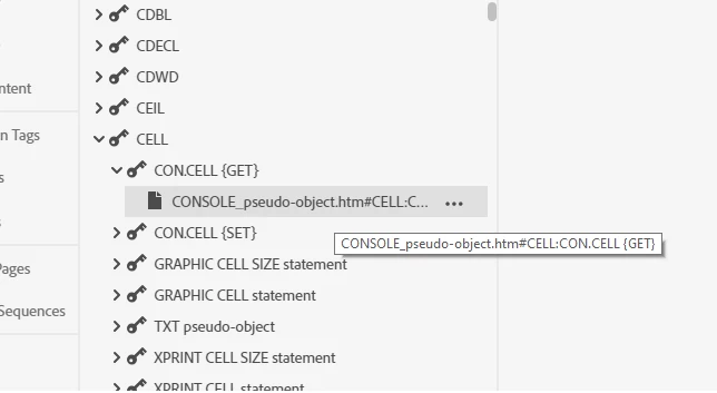

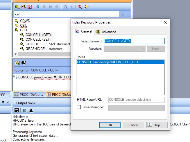

I have extracted samples from RH10 and RH2020 for comparison. What it appears to be doing during the upgrade is it is mis-forming links in sub-topics in the index. It is taking part of the keyword, and the subkeyword, and replacing the actual anchor in the link with that.
Example (viewing link properties of compiled CHM while navigating in html help ui):
Correct link in RH2010 (keyword COL, Subkeyword CON.VIRTUAL.COL):
CONSOLE_pseudo-object.htm#CON_VIRTUAL_GET
Incorrect link in RH2020:
console_pseudo-object.htm#COL:CON.VIRTUAL.COL
However, what's really strange - if I double click the main keyword, that has subkeyword references, where it will bring up that indented list in a popup window, if I click the particular one down in the list I'm trying to go straight to in the Index listbox, it works from the secondary popup (though all of the subkeywords display as the main keyword only).
