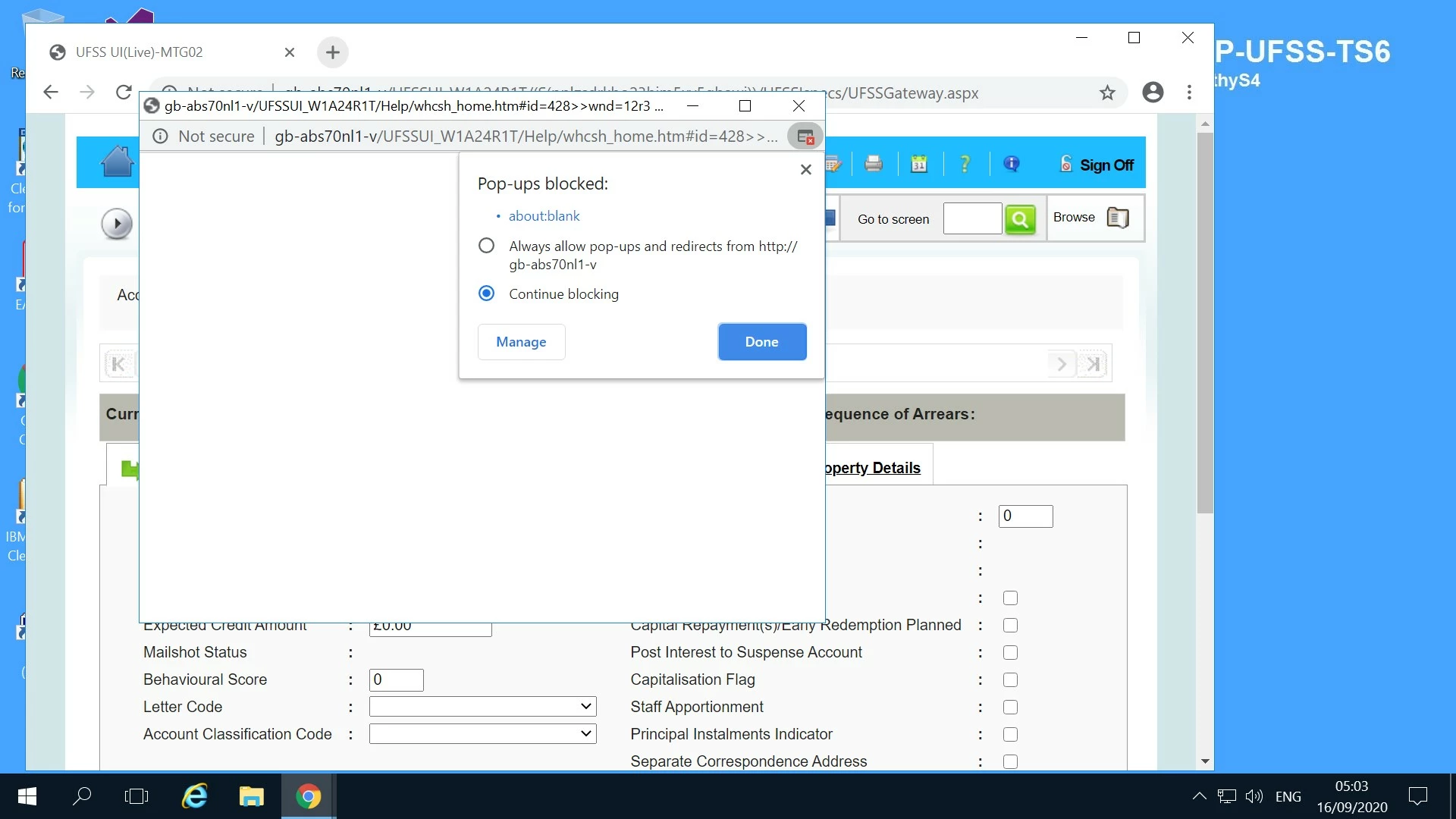

What options do you get when you select "Manage" in that dialog? Maybe all it takes is to add the help site to a list of safe sites in the browser?
Have you tried launching the help outside the application with that exact CSH path? Do you get the same effect as launching within the application? What parameters are being used to launch the help in the app? I would have expected to see it open a new tab instead of a new window.

I get this notification in my browser (top right corner) when i open the Helpfile through the application.
 Pop-ups Blocked: There are two options i can select;
  • Always allow pop-ups
  • Continue blocking
When i select Always allow pop-ups i get two blank screens which appear and immediately disappear. If i select Continue blocking, i get one blank window.
