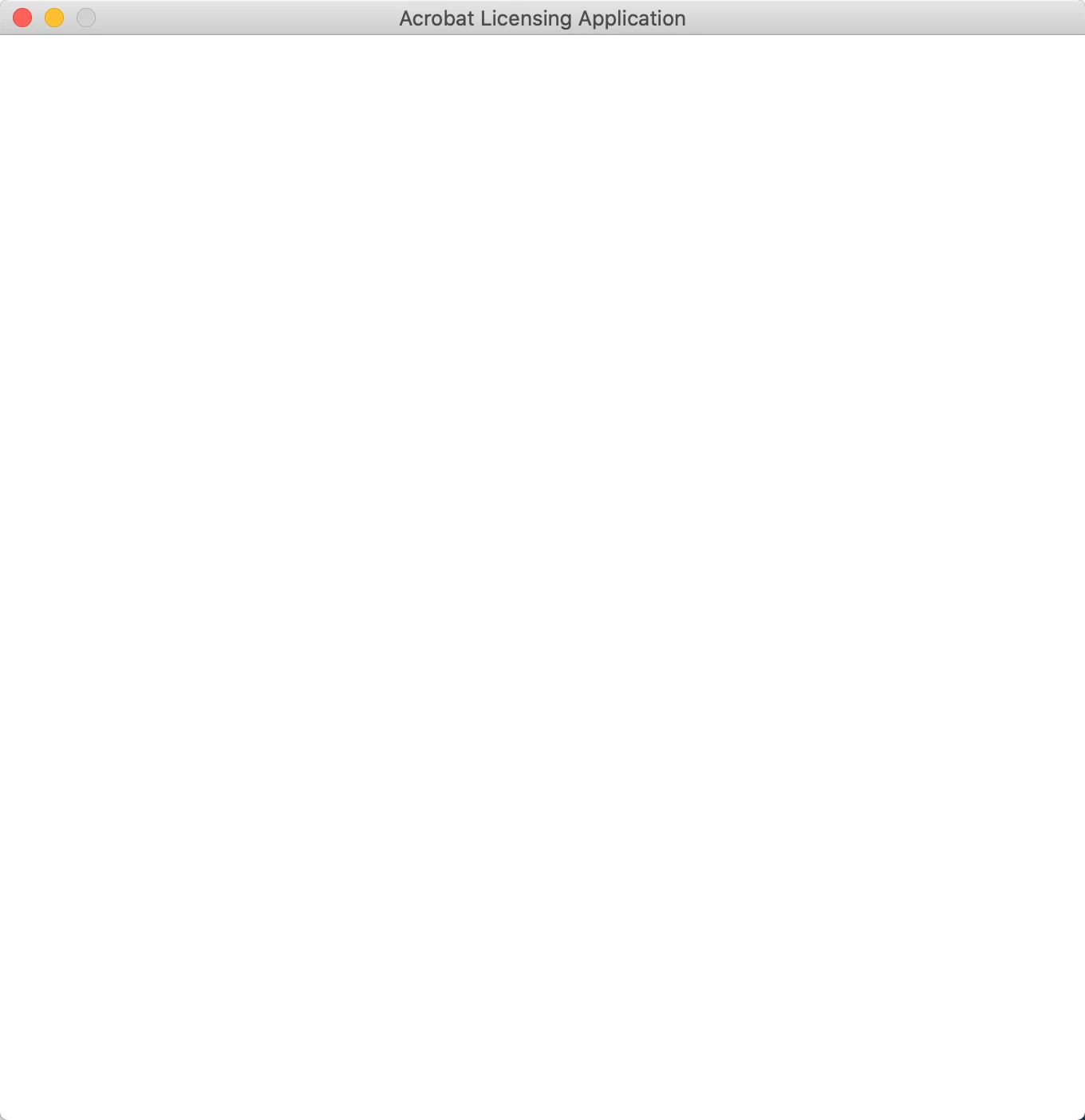

Acrobat Licensing Application hangs after login on Mac OS 10.15 (Catalina)
I bought a license for Adobe Acrobat Pro 2017 and installed a freshly downloaded version from the Adobe Website on Mac OS 10.15.1. After login with the Adobe ID I get the following screen and cannot open Adobe Acrobat. The same problem is reported here: https://community.adobe.com/t5/acrobat/adobe-acrobat-2017-pro-mac-os-10-15-can-t-install/m-p/10686836#M223379 but no solution is given. Any help would be very much appreciated.

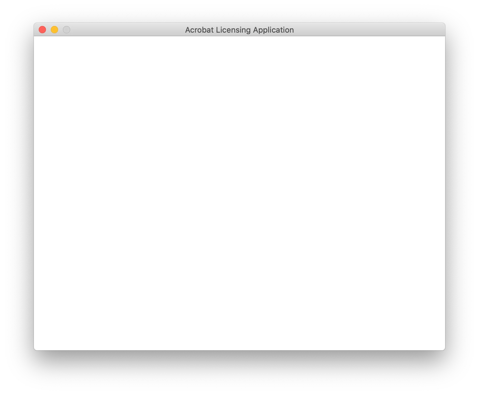

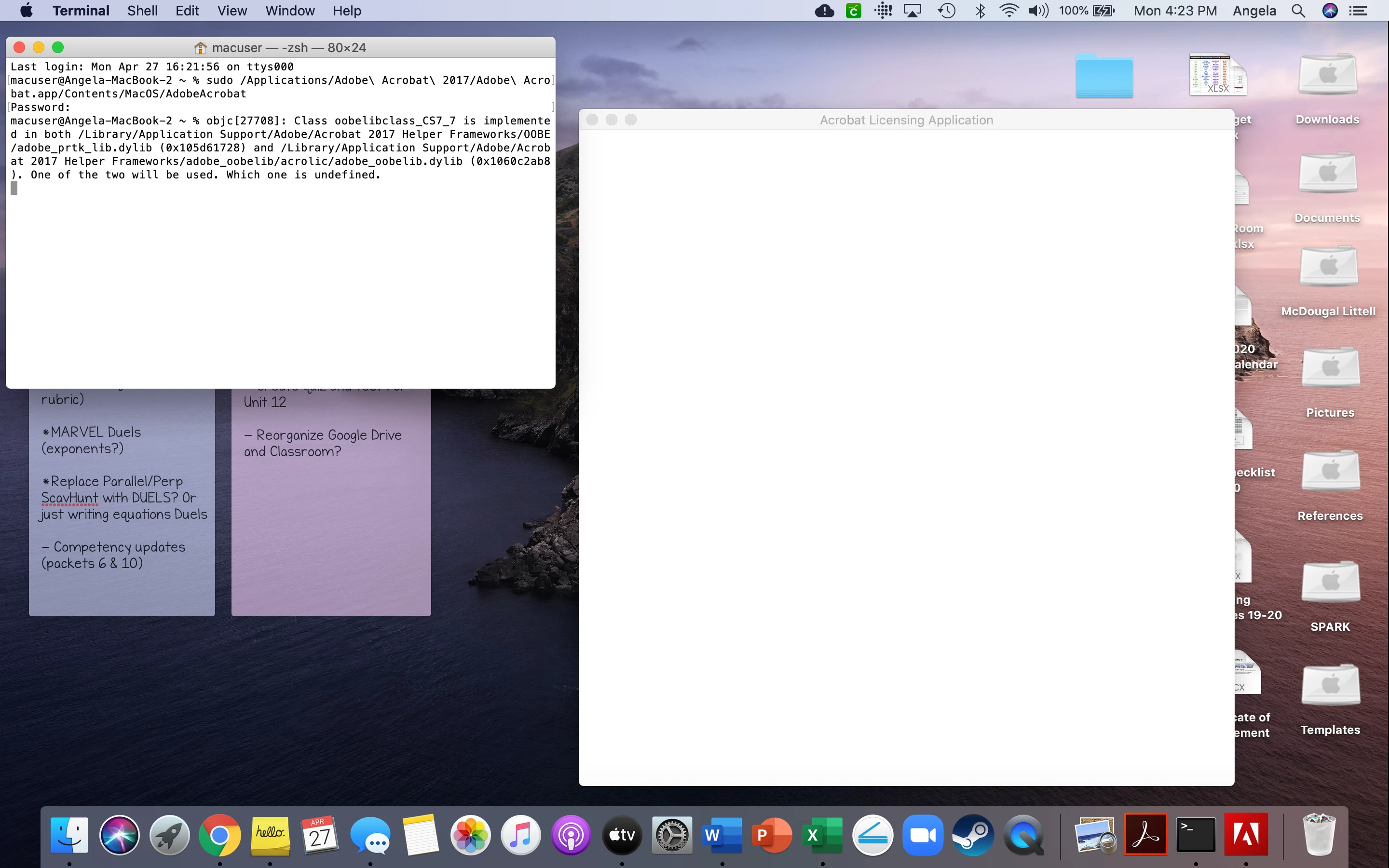

Recently I upgraded my Mac, and am now using Catalina. I reinstalled Acrobat Pro 2017 and for about a week, it worked fine! I was able to use the application without trouble. When trying to open a PDF today, the Adobe Licensing App opens up and prompts me to sign in, leading only to a blank screen. I came to the thread looking for help, and tried the suggestions given. Even when opening from Terminal, the licensing app does not allow me to put in a username and password after clicking "sign in". I have uninstalled everything Adobe related, reinstalled 2017 making sure it's the latest version, and tried running sudo in terminal. Nothing is working for me, please help!

I have the same issue after upgrading my mac, I go to open Adobe Acrobat 2017, AcroLicApp opens, click Sign in, then nothing happens. Have tried the sudo suggestion in Terminal after reinstall, still no joy. Any other suggestions would be grateful.

I have the identical issue, on a new Mac I tried installing Acrobat Pro 2017 (bought the license 2 years ago already), Install worked fine, when I start Acrobat, Acrobat closes and the Acrobat Licensing Application launches with just a White Screen.
Already tried the mentioned Terminal/Sudo approach, no changes.
