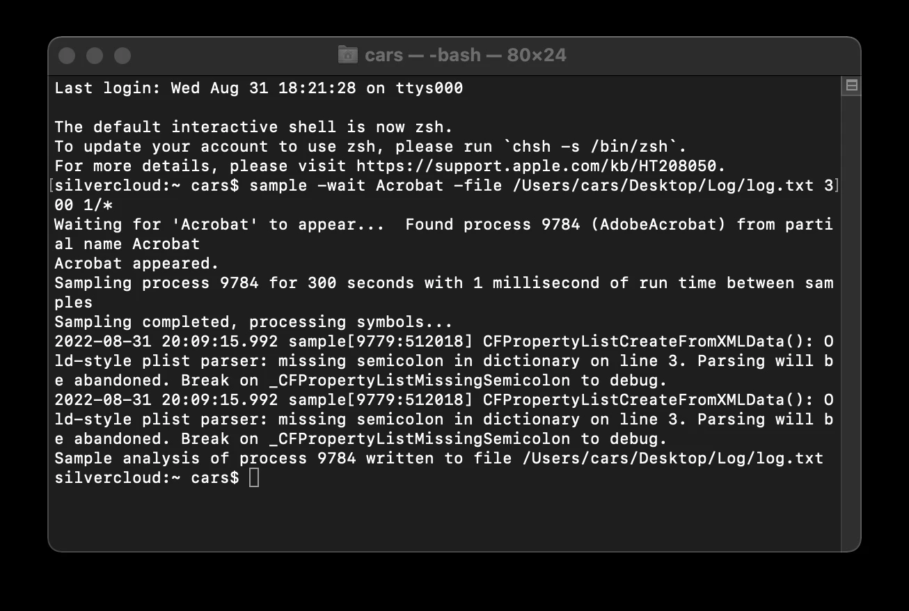

I tried this out yesterday and will do it thoroughly today.
However when using the "-file <folder path>" command, it tells me, that it couldn't write the log to the destination.
Shall I let it write the log into a .txt file? And do I just upload it here when it's done?

Hi Vinod,
I was able to complete the sample. Please find the log and a screenshot of the terminal attached.
Hope this helps to find a solution..
