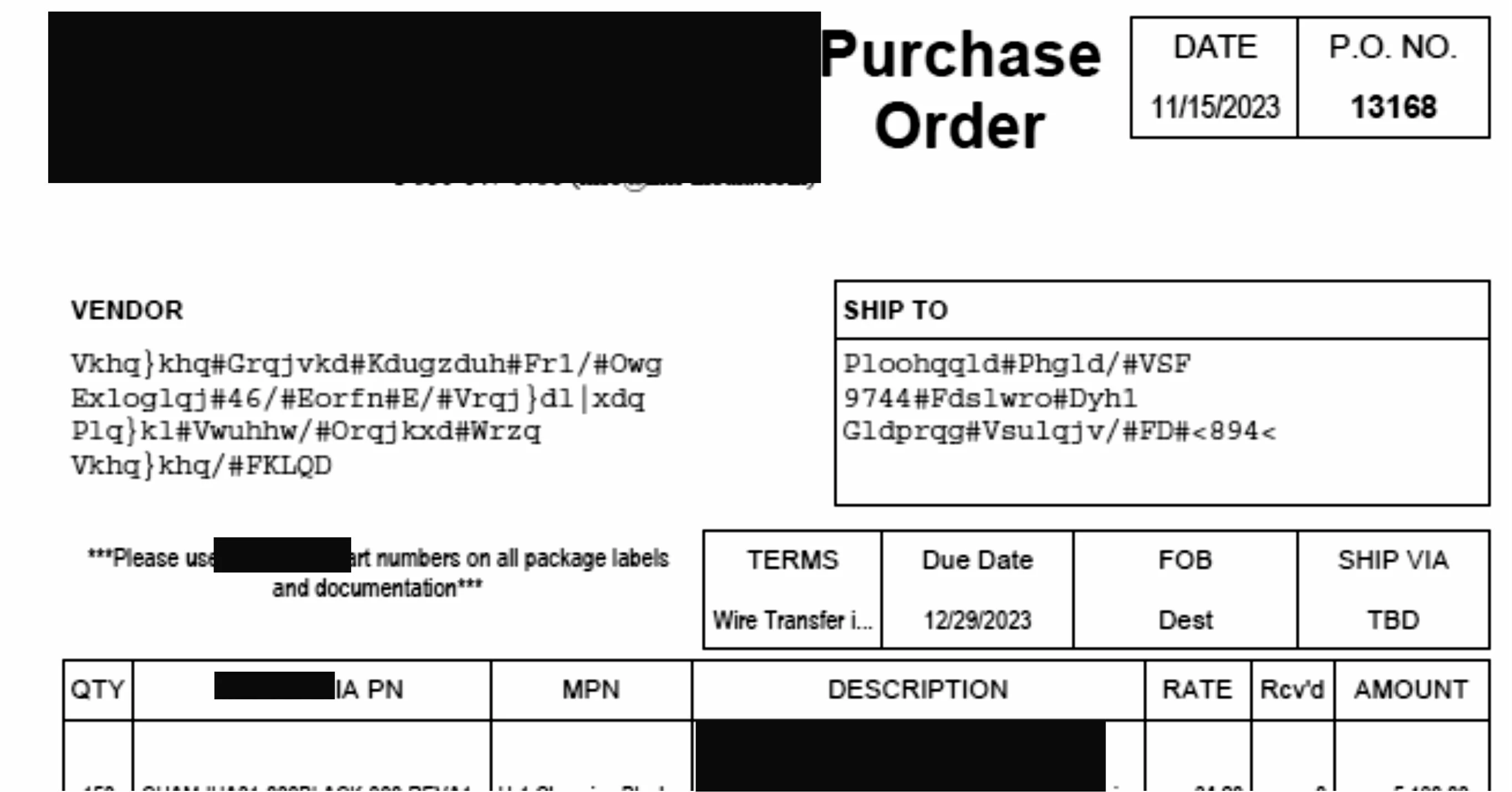

On a number of occasions, Acrobat Pro prints out gibberish / random characters. For instance, in Quick Books, a purchase order address becomes gibberish (see attachment). Here's the thing: when I print the identical QB page in alternative PDF makers (PDF995, ABS PDF, and Microsoft Print to PDF), the text is correct. Why do all the PDF alternatives work, and Adobe's PDF fails?!?

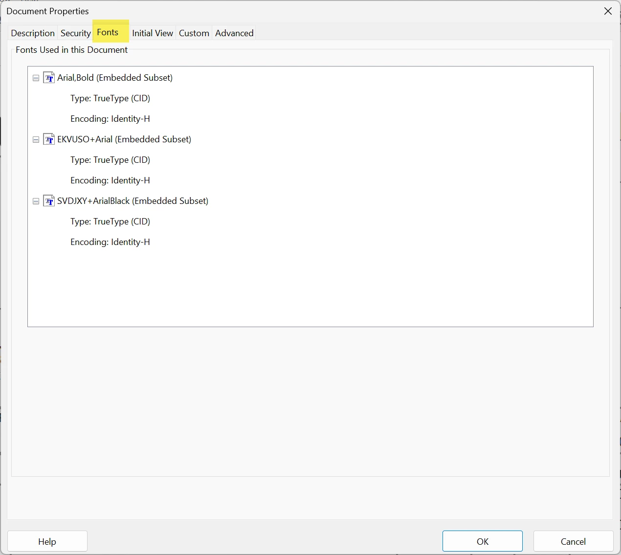

Maybe they've become corrupted over time? Moved or have had their names changed and QB can no longer find them? You can discover which fonts are being used in your PDFs by viewing the Fonts tab in File / Description. Also note if each font is "Embedded" or "Embedded Subset" in that listing: that's required to ensure the file can be read by any PDF reader, and Adobe brand or by someone else.

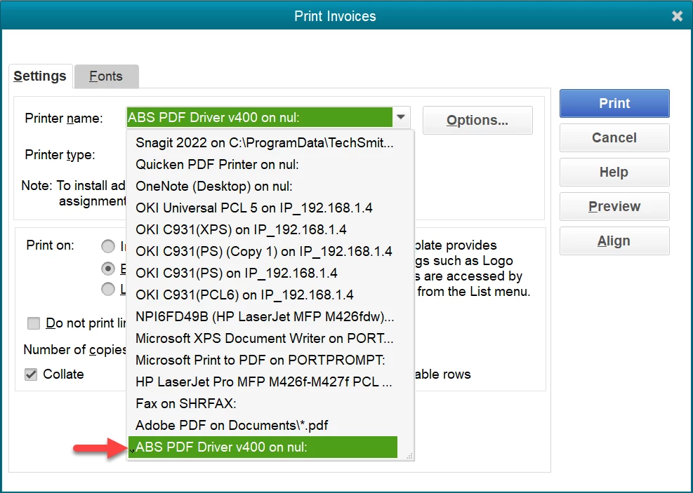

2) How the PDF was created.

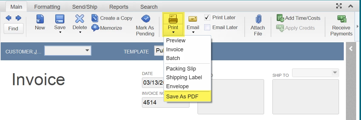

There are a bazillion ways to make a PDF from any program, but the best method is by using the program's built-in utility.  In QB, that could be the Save as PDF utility found on most of QB's modules for invoices, reports, etc.:
Or File / Print ... and select ABS PDF Driver, which is a virtual printer installed with QuickBooks. (It's made by Atlas Business Solutions.)
If you're having problems with this print driver, check directly with QuickBooks as it's their puppy. You can also search for "ABS PDF Driver" and a zillion hits will come up. Looks like you're not alone with this!  You might need to reinstall the driver by following the suggestions you find in your search.

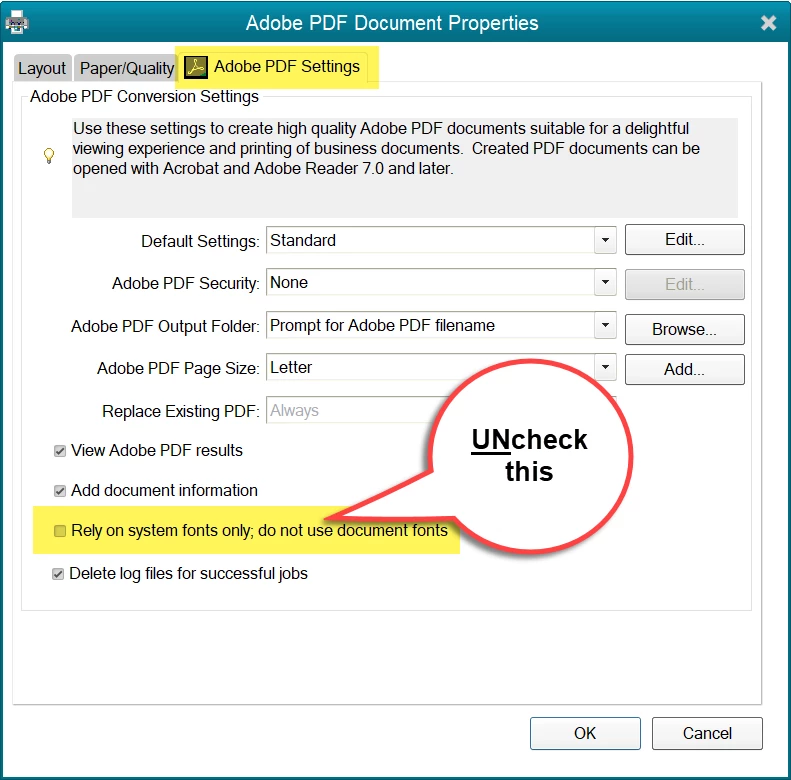

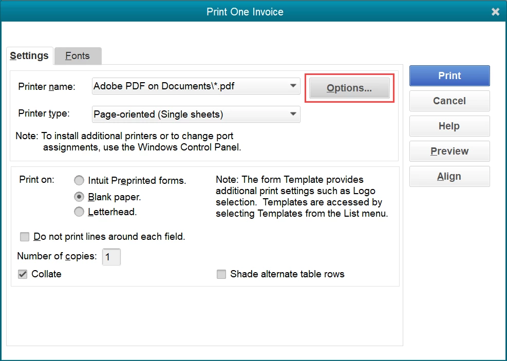

OPTION: Print to an Adobe PDF driver.
Adobe usually gives more granular control over how the PDF is created, especially regarding fonts. Set the Options to NOT rely on system fonts: UNchecking this forces the fonts to be embedded into the PDF.

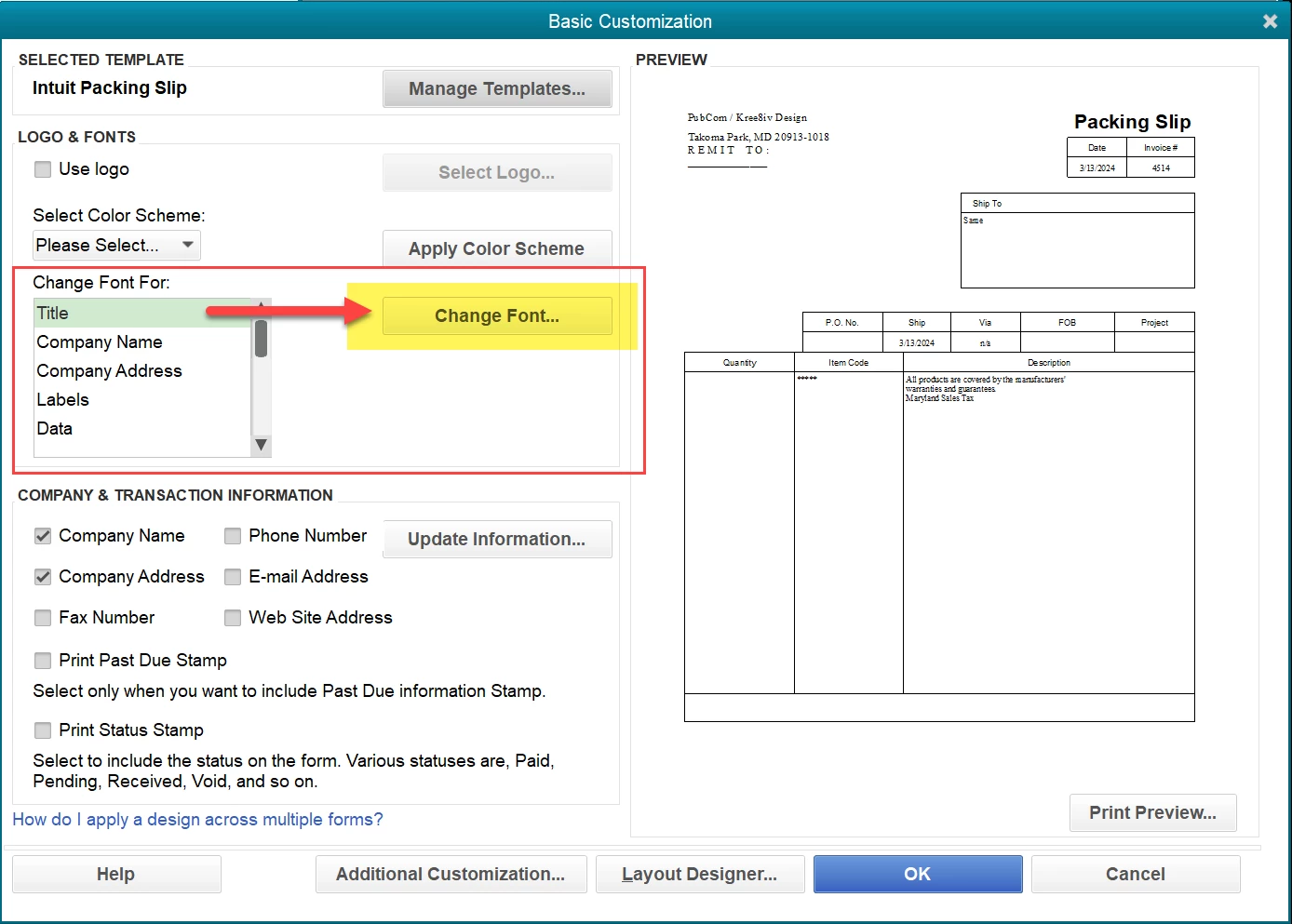

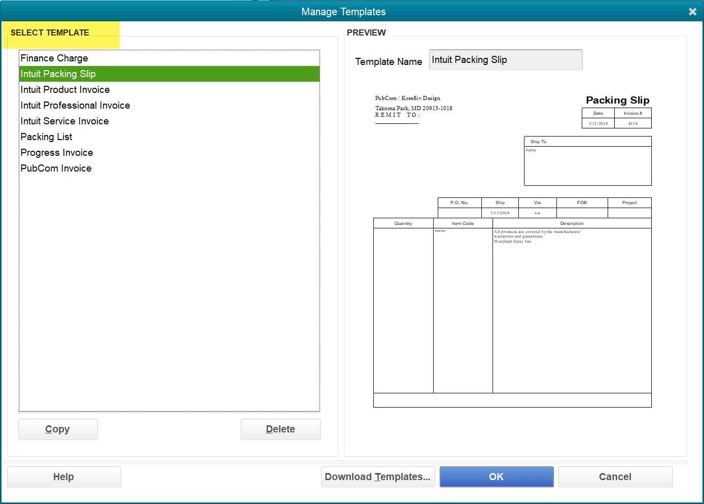

3) The fonts selected in your QB template.
I noticed that the base structure of your purchase order is coming out fine: the pre-defined labels for Purchase Order, Vendor, Ship To, and the column headers are all rendering fine. These are controlled by QB's template.
But the fonts for the field data  — the vendor's name and shipping address for example — are controlled by whatever you selected in the QB template. So open your template editor module in QB. In recent editions of QB, it's called Manage Templates and is available from many menus, but often in the module you're using. So look for "Format" at the top of your Purchase Order module.
Make sure each field in your template is specking a font that is currently available on your computer. A previous font might have become corrupted or been moved or even renamed.

In reviewing your sample, I noticed that the gibberish text doesn't look like the usual gibberish from a missing font; it looks like code thrown into the Vendor field. And that makes me wonder if the QB database table that stores your vendor, shipping address, etc. data is OK. That could have become damaged over time, too.
