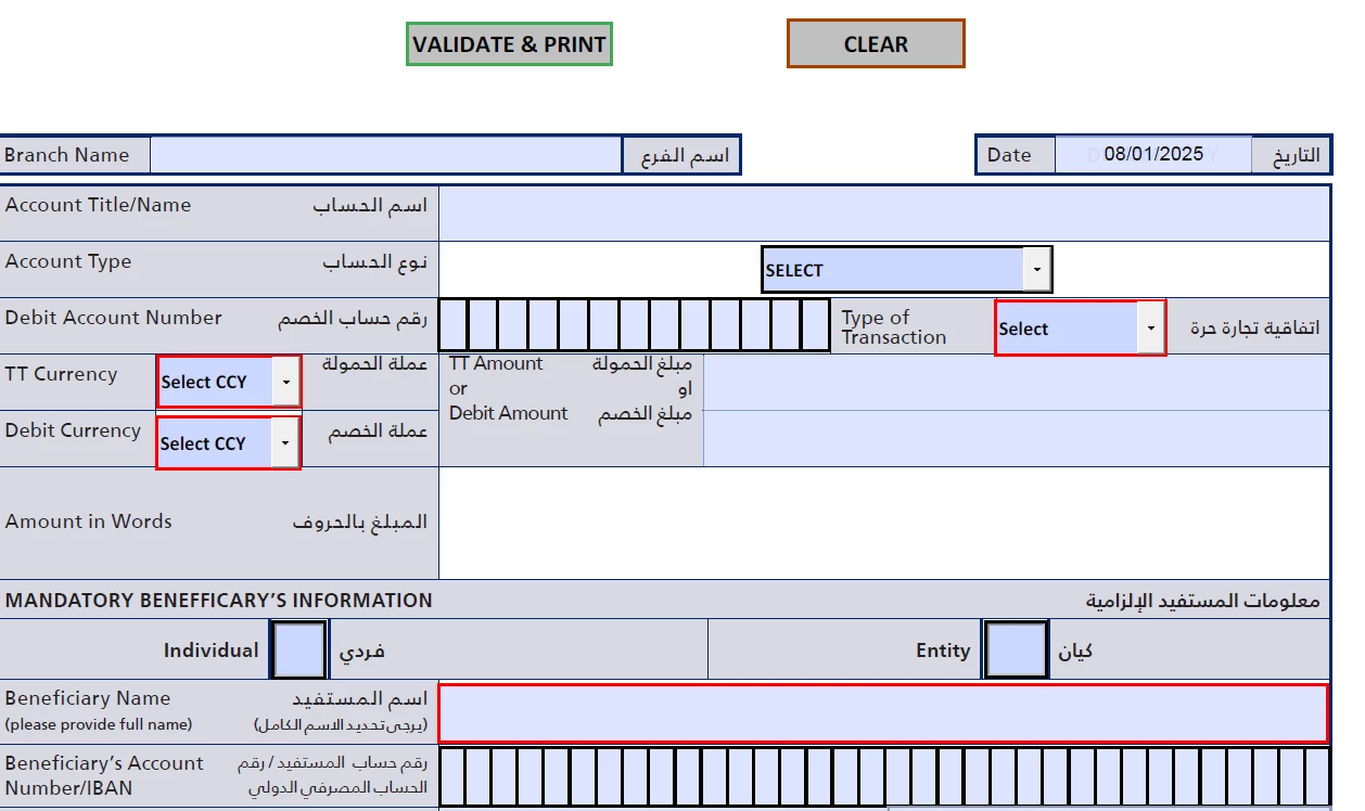

Adobe PDF- Want to Print Disable until validation is done
We would like to explore the option of implementing a new document action that triggers the code to validate the necessary mandatory fields prior to printing the form.
Validate and Print function is working perfectly. But when we do ctrl + P, then this validation don't work. How to invoke validation before ctrl+P or print symbol on the top.
Let me knwo any solution.
