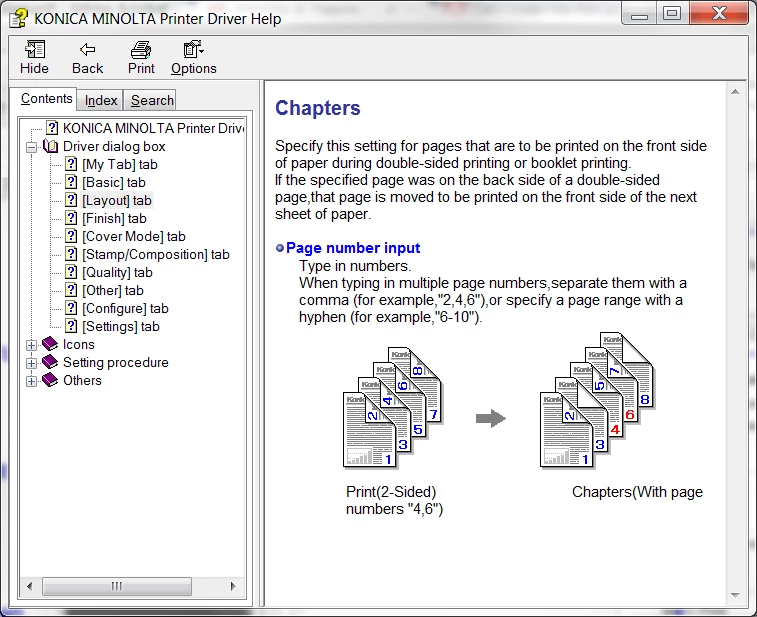

Here is a screenshot of the details of the "chapters" function which is a printer property. The printer I am using is a KONICA. I am guessing they will probably know the answer to my question best since the chapters function is not an Adobe feature. I am lead to believe the reason it is not working for me is that I can't use the chapters function and also select multiple page ranges to print. I tried selecting just one page range and did a test print and the printer feature partially worked, meaning it placed some of the even numbered pages I selected on the right side but didn't capture all.

Adobe Acrobat does not know about the chapter feature of your Konica printer. May be Konica has a kind of plug-in for Acrobat. As a worst case, you need to use the Konica feature without support from Acrobat.
