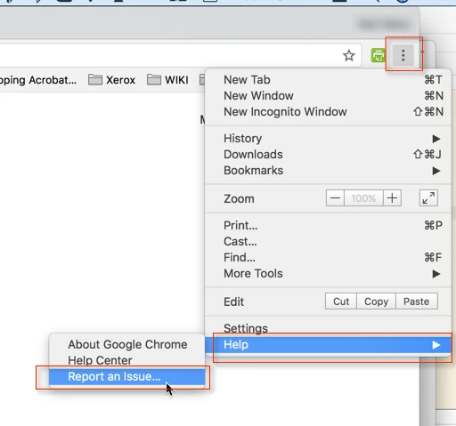

Correct answer Karl Heinz Kremer
The Chrome browser (and FireFox and MS Edge) uses it's own PDF viewer. If you are running into problems with that viewer, with a file that renders correctly in Adobe Acrobat or the free Adobe Reader, the problem is in the browser software. You need to file a bug report about Chrome's PDF viewer with the Chrome development team. You can do this from within Chrome:

Without knowing how exactly the Chrome PDF viewer works, it's impossible to say what exactly is triggering this particular problem. It could be due to the font you are using, or how the PDF file is organized internally. What it comes down to is that Chrome is not processing something in your PDF file correctly. It's very likely not the PDF file that is the problem (you can view it correctly in Acrobat), but how Chrome is rendering your specific file.
