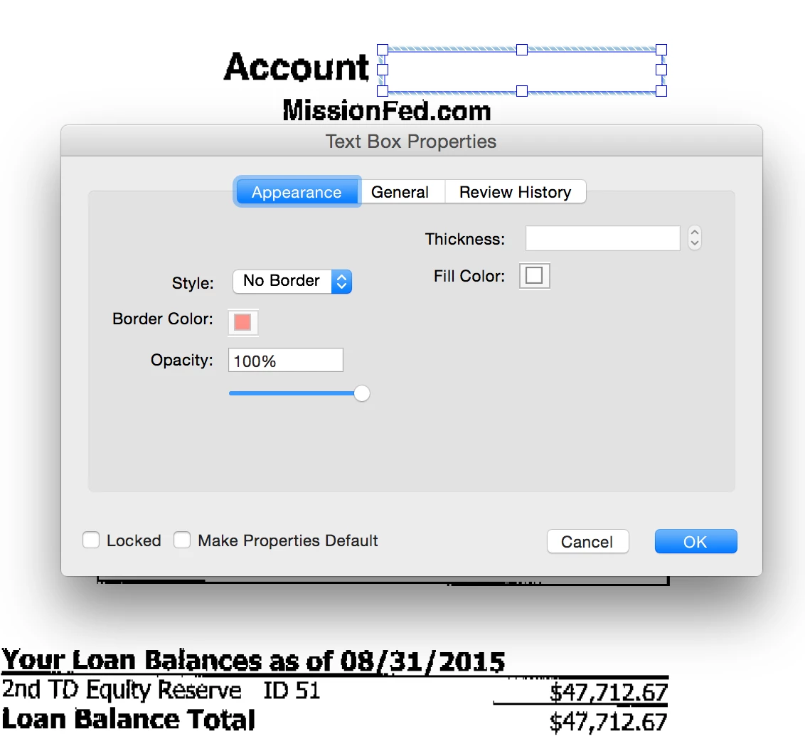

tjk84938930
Oct 14, 2015 9:35 PM UTC
If only it were that easy. Please see the attached screenshot. It only gives me border color and fill color options. In the example let's say I wanted to whiteout the word "Statement" after account, and replace it with "Balance". I cannot bring the word Balance to the front of the white comment box. It defaults to hiding it behind it. Someone please help.
Oct 15, 2015 4:34 AM UTC
A more consistent approach would be to redact the content you don't want and then use the text box to add the text you want. I suggest that you then flatten the text so it's no longer a comment, which you can do with the following free JavaScript-based tool: UVSAR : Selective Flattener tool for Adobe Acrobat 8, 9 and X
