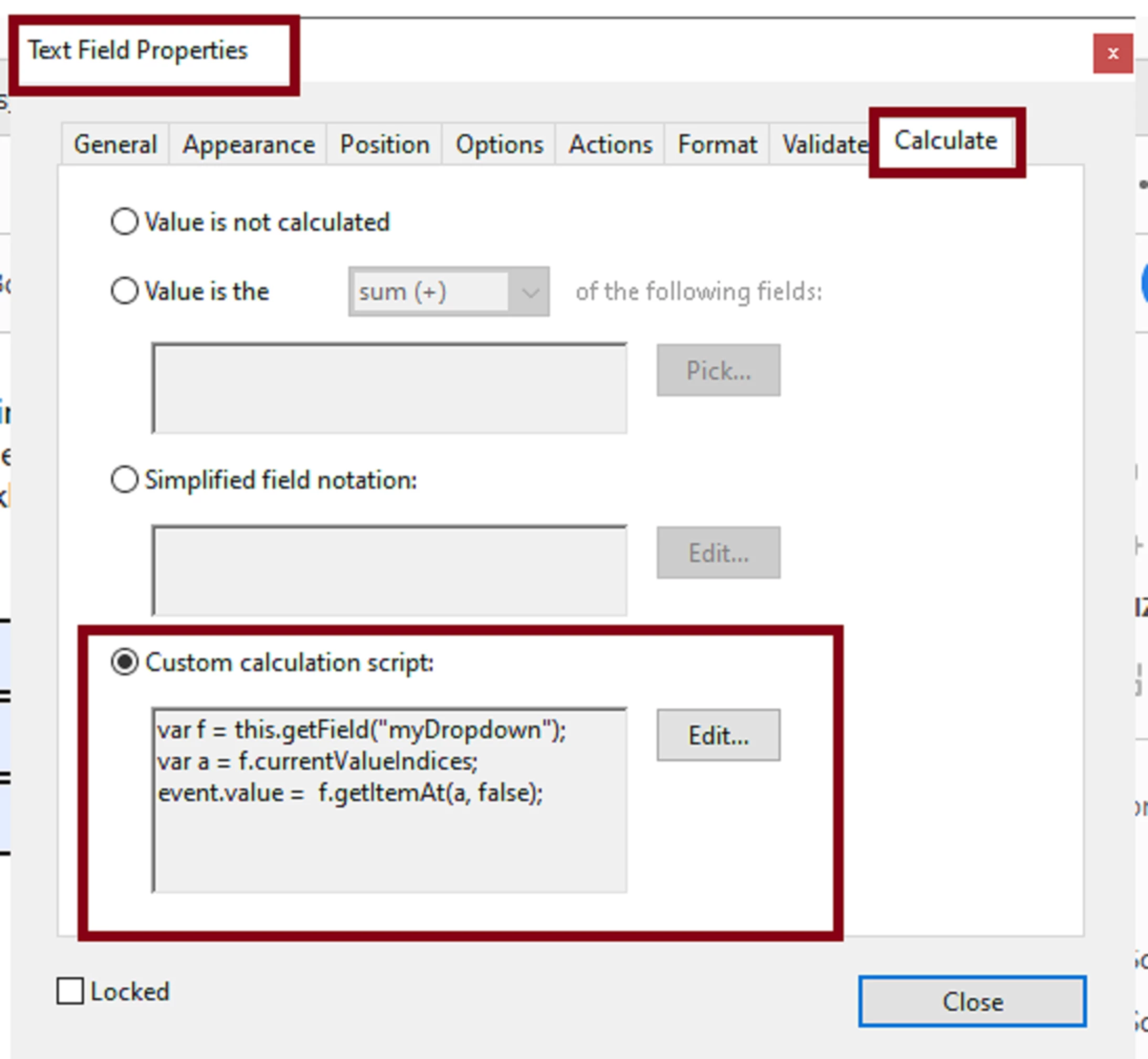

I'm pretty new to scripting for PDF forms, please could you help me?
I have a dropdown box with 2 items in it 'ITEM A & ITEM B' with values $20 for ITEM A and $30 for ITEM B. I wish to copy the selected ITEM (and not the VALUE) to a new textbox. Is there an easy way to do this, I have seen a couple of scripts online but none seem to work for me or maybe I'm just doing it wrong. If you are kind enough to be able to help could you please refer to where the script should sit in either the Dropdown box or the textbox. Thank you so much.
Correct answer ls_rbls
I prefer to run the script from the texfield using a custom calculation script. See the method below:
var f = this.getField("myDropdown");
var a = f.currentValueIndices;
event.value =  f.getItemAt(a, false);
The field method above employ the use of "currentValueIndices" to get the index of the listed items in your dropdown menu which is declared in variable "a" in the script above. Then you use "getItemAt" to get the face value of that indexed item.
According to the Acrobat API reference you cannot get the face value of a combobox using the regular method unless both the face value and the export value are the same. In other words, if you only need to get the export value then just use :
event.value = this.getField("myDropdown").value;
as the custom calculation script in your text field.

Thank you so much, super quick and worked like a dream. Perfect answer and so informative I feel I've actually learnt something rather than just copying and pasting a snippet. It's a shame this is not a standard in the calculation options (show item selected with a reference) I know you should use the value as the selected item but if that is being used for another calculation then the item is nnext best thing). Thank you again you are a credit to the community.
