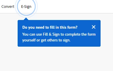

Feb 27, 2024 11:11 PM UTC
I need these pop up notifications about using Acrobat features TO STOP. It interrupts my work all the time. See screenshot of one as example.
