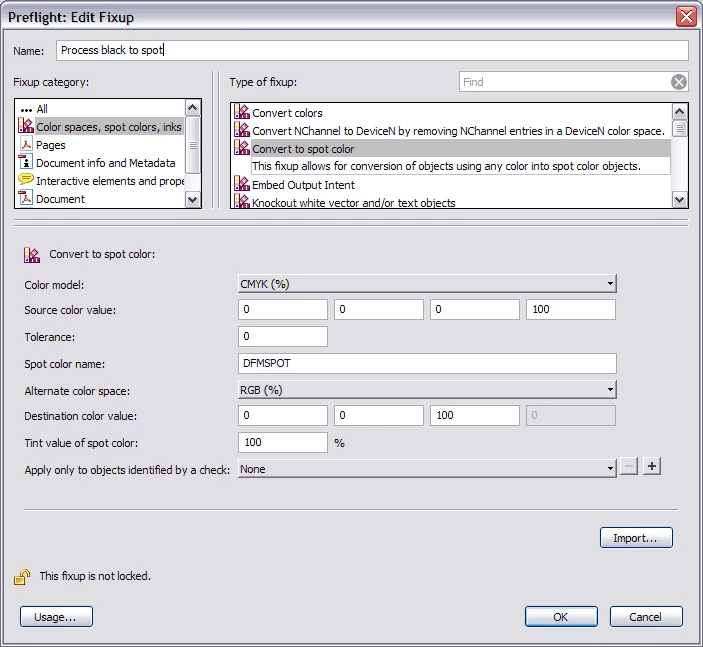

1 - yes, you can do this with Preflight in Acrobat Pro, but it's not on the default set of fixups.
  • Open Preflight, select "Single fixups" - the wrench icon
  • Options > Create New Preflight Fixup
  • Give it a name (e.g. "process black to spot")
  • Choose the Color category in the upper right
  • Choose 'Convert to spot color' in the upper left
  • Define the source parameters in the main panel (in your case, CMYK%, 0-0-0-100 with tolerance 0)
  • Define the spot color to change this color into, and the alternative space for rendering (i.e. your blue color)
  • If you wish, add a check to limit the conversion to certain things (e.g. text, vectors, etc.)
Click OK to save the fixup, then click FIX to apply it. To verify the result, use the Output Preview dialog in Acrobat.
