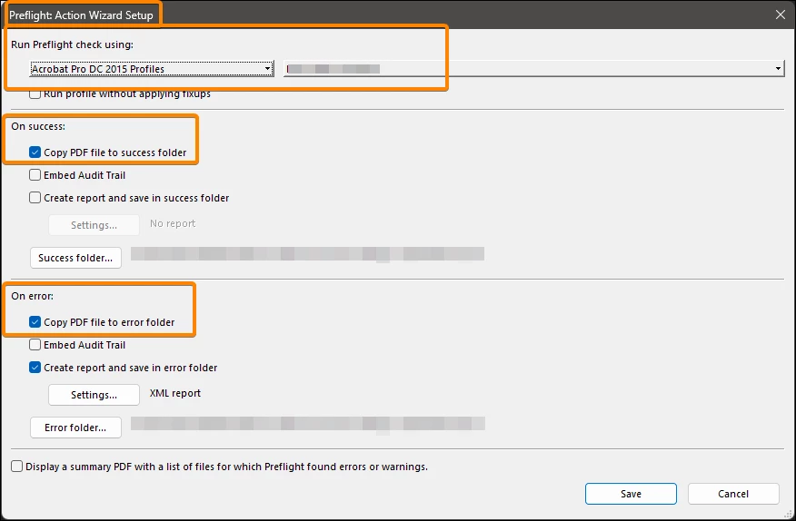

PS: an Action can't move files into the Success/Error folder, it has to copy them, but this isn't a real problem.

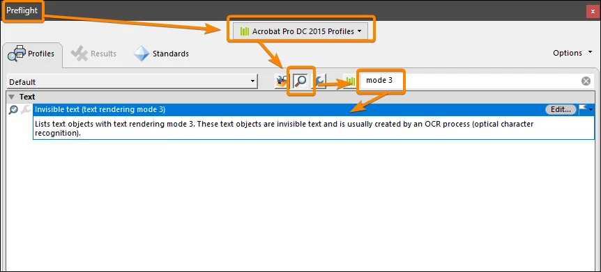

1. Sort files using a Preflight profile in an Action that place them in two folders (Success or Error).
Search for "mode 3" in Preflight, this Check characterizes OCRized files, and embed it in a custom Profile (an Action can only use Profiles, not a Check directly).

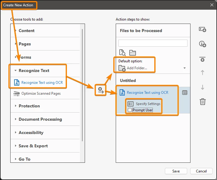

2. Use an Action to OCRize those that are not.
