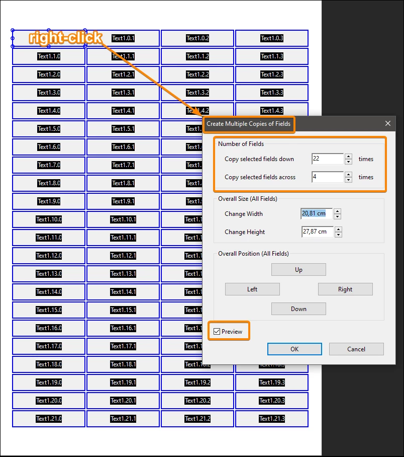

JR Boulay
December 9, 2022
Create the first field with all its options, then right-click : Create multiple copies.
All fields are automatically named.
try67
December 9, 2022
But you can't control how they are named, it's automatic.
